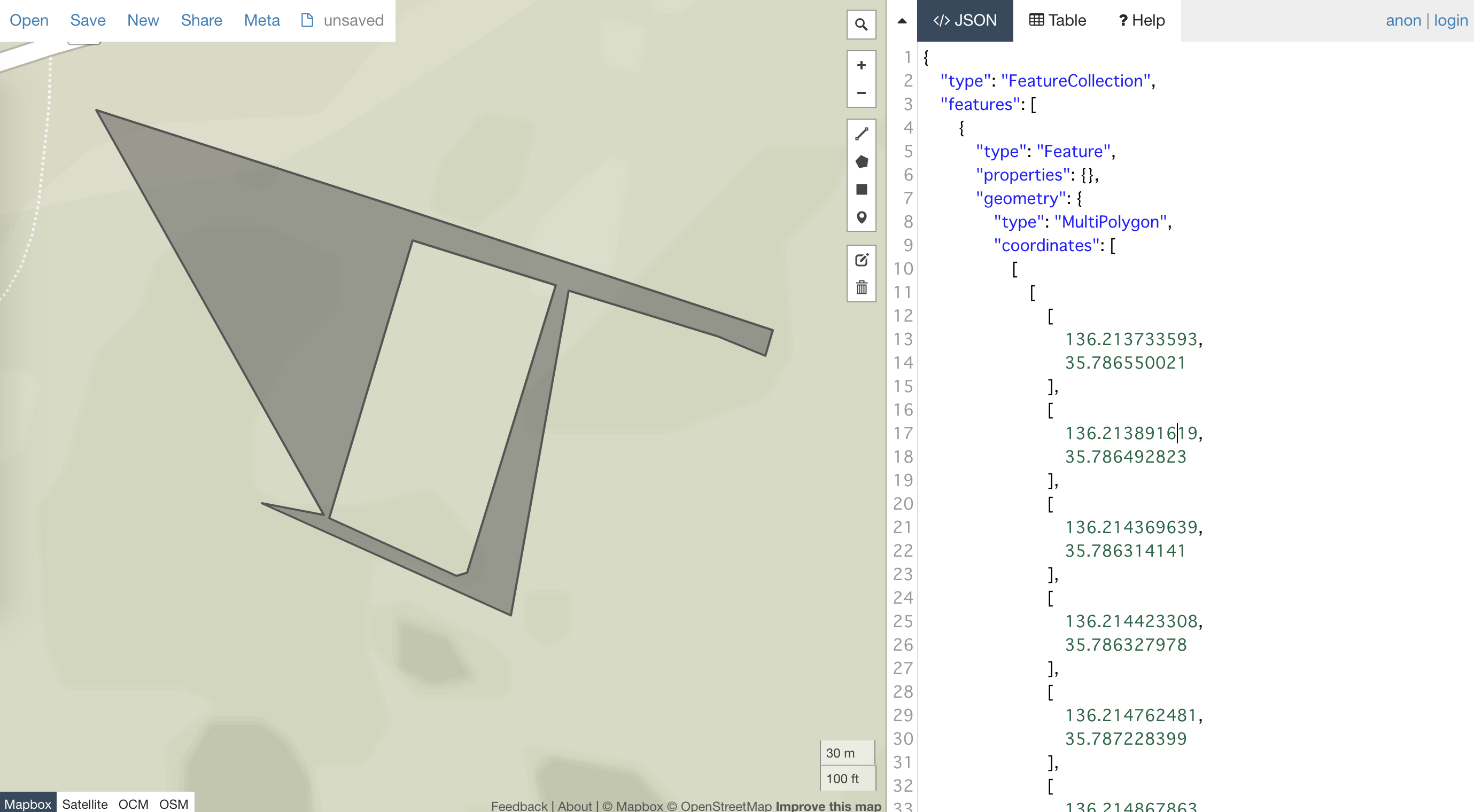

Can not create a document has mutlipolygon having hole
Hi, can anyone help me
I am facing a following.
Summary
Can not create a document has mutlipolygon having hole.
I do not know why responses reason is correct or this is bug?
I have visualize the multipolygon, using geojson.
But , It seems correct polygon, I mean hole is within polygon.
Another document has polygon having hole is successfuly created.
So I guess specific polygon data can not be created.
Expected behavior
The document is successfuly created.
Actual behavior
Can not create a document.
The reponse is status 400.

Your data is not valid GeoJSON - you should put the outline of the shape first and then list any holes, but instead you have put the hole first and the outline second, hence the message about the hole not being within the outline. If you switch them over then it should work:
    "coordinates": [
            136.213703006,
            35.786561093
            136.212561159,
            35.788209032
            136.214047375,
            35.787822628
            136.215960152,
            35.787316346
            136.215922928,
            35.78721168
            136.215682347,
            35.787289767
            136.214932678,
            35.787475211
            136.214644095,
            35.786154679
            136.2133956,
            35.78660853
            136.213703006,
            35.786561093
            136.213733593,
            35.786550021
            136.213891619,
            35.786492823
            136.214369639,
            35.786314141
            136.214423308,
            35.786327978
            136.214762481,
            35.787228399
            136.214867863,
            35.78749709
            136.214150004,
            35.787679904
            136.213733593,
            35.786550021
Thank you so much for your quick reply.
I have understood the reason why. The data is invalid GeoJSON.
