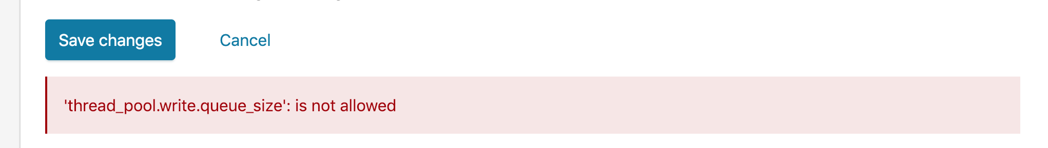

So following this doc on how to change the elasticsearch.yml setting I try to add the queue_size bump here:
42%20PM
thread_pool.write.queue_size: 2000
And when I save I get this error:
'thread_pool.write.queue_size': is not allowed
I understand the user override settings blacklist certain settings, so if my problem is truly that thread_pool.write.queue_size is blacklisted, how can I access my elasticsearch.yml file to change it?

That being said, do you know I can access the proper elasticsearch.yml file, or is the user setting override the correct one and I'm not using the correct setting?
Thanks!
You can see what settings you can alter right here - https://www.elastic.co/guide/en/cloud/current/ec-add-user-settings.html#ec-es-elasticsearch-settings
If it's not listed, it's not alterable.
