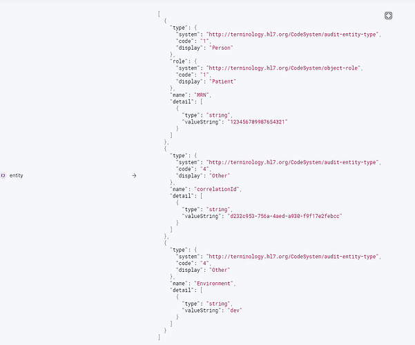

What I am working with is lots of JSON with entity, an array of objects that looks like this when viewed through the Elastic index page.

In my situation, I know filtering does not work. I have already tested it with multiple different filters, both using a regexp query and a term query. I believe it doesn't work because filters I think just sort JSONs on whether something exists, it doesn't filter out unwanted terms in entity.detail.valueString.keyword like the Include Values field mentioned earlier does. My entity arrays will always have a correlationId, which is what I am trying to track, but they will also always have other values in other objects' valueString, such as numbers, names, etc.
