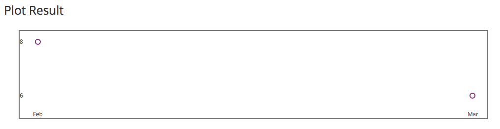

You can go even further and cast the value into an actual month name, using mapColumn:
filters | esdocs index="wbs*"
| alterColumn "activity month" name=activity_month
| mapColumn activity_month expression=${getCell activity_month | formatdate "MMM"}
| pointseries x=activity_month y="sum(total_activity_hours)" color="hml"
| plot defaultStyle={seriesStyle points=5}
| render
Hope that's all helpful!
