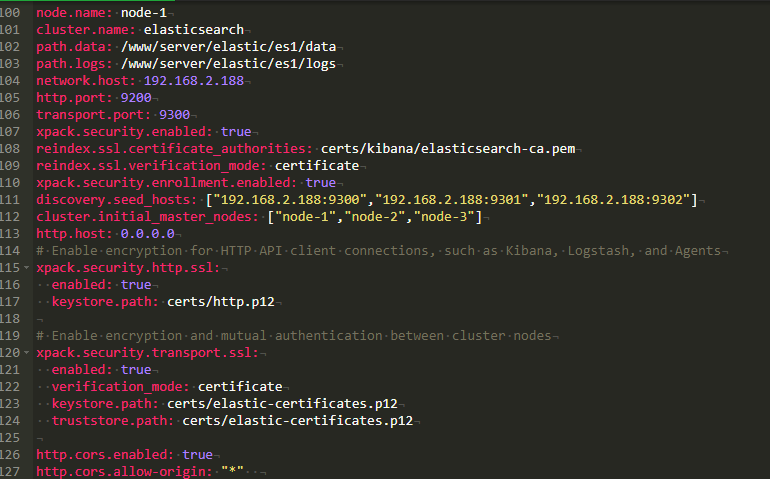

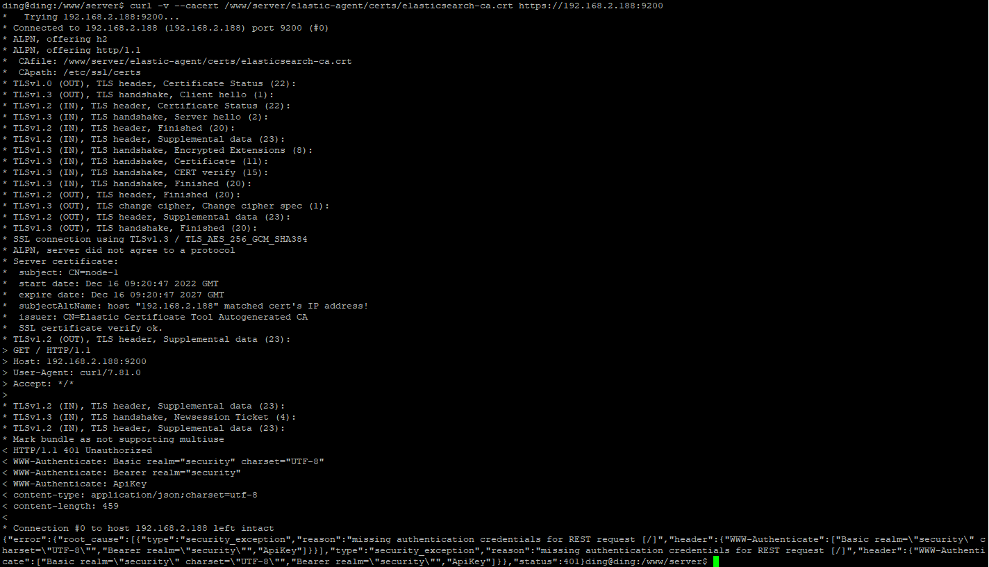

I can use  curl --cacert /www/server/elastic/es1/config/certs/elasticsearch-ca.crt -u elastic https://192.168.2.188:9200 this command to connect
Use the
curl -v --cacert /www/server/elastic-agent/certs/elasticsearch-ca.crt https://192.168.2.188:9200 this command without identity credentials

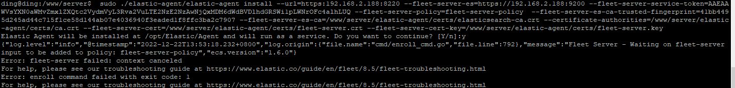

              There is no certificate error now, but I have been waiting for the installation of the fleet server
              Is there any log file? If yes, can you share the content of the Elastic Agent log?
              If there is no log information, you have to wait all the time. After waiting, an error occurs. You cannot install the fleet server, like this
I put elasticsearch-ca.crt in the directory/usr/local/share/ca-certificates, so there is no certificate error, but the fleet server has never been installed
              If I delete the certificate in the/usr/local/share/ca-certificates directory, a certificate error will occur
              I think we have established that the certificate is correct. The Fleet Server seems to not able to retrieve the Fleet server policy from Elasticsearch. Can you also share the agent policy?

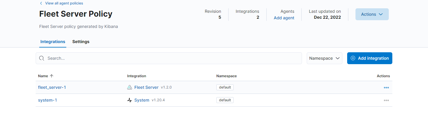

              This policy doesn't have fleet-server integration. You need to add the Fleet Server integration to this policy in order to use this policy for the Fleet Server.

              Is there a fleet server integration,This is what I just sent
              But I still can't use this installation
              Yes, your second policy contains Fleet Server integration, which looks correct.

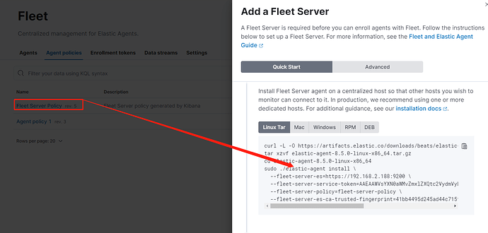

 sudo ./elastic-agent/elastic-agent install -f --url=https://192.168.2.188:8220 --fleet-server-es=https://192.168.2.188:9200 --fleet-server-service-token=AAEAAWVsYXN0aWMvZmxlZXQtc2VydmVyL3Rva2VuLTE2NzE2OTgzNTI2NjM6cDZseURVWlFRSHVOZTY5bDloTERwQQ --fleet-server-es-ca=/www/server/elastic-agent/certs/elasticsearch-ca.crt --certificate-authorities=/www/server/elastic-agent/certs/ca.crt --fleet-server-cert=/www/server/elastic-agent/certs/fleet-server.crt --fleet-server-cert-key=/www/server/elastic-agent/certs/fleet-server.key

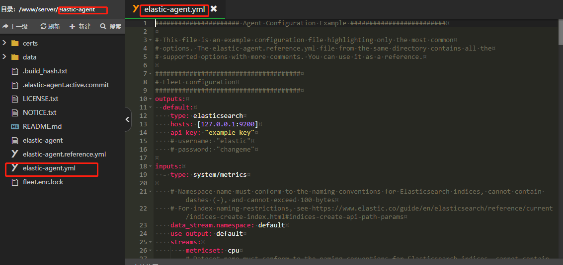

              Can you try to remove ssl.ca_trusted_fingerprint and add ssl.verification_mode: none in your Elasticsearch output configuration? See if that works.
I noticed you were using a different service token to enroll the Fleet Server this time, which worked, so as suspected, the service token was incorrect.
              This parameter does not work. My elasticsearch version is 8.5.0
              I meant to add that ssl.verification_mode: none into the Elasticsearch output configuration in Fleet, not in elasticsearch.yml file.
              In which file,is it in here
              Go to Kibana, Fleet > Settings > Elasticsearch output settings. There is a box where you can enter YAML configs.
              The first one cannot be changed. I added one, but there was an error
