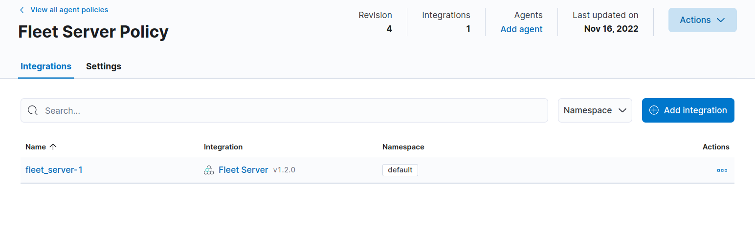

I've tried different dicisions from here and here. But nothing helps. I have policy "Fleet Server Policy" with Fleet Server integration.
