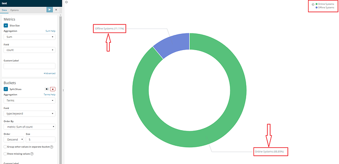

I have an index with 2 docs where i store active / inactive systems (one doc for 'active' and the other doc for 'inactive'). This index is refreshed every 10 minutes with new values of active / inactive systems.
How can i change the color - label names in top right of my pie chart as it is shown in the image below? I just want to display 'active' for the green and 'inactive' for the blue.
Hi @johnkary,
can you how the chart is configured (metrics and buckets) and how your data looks like?
Hi @flash1293 and thanks for the quick response!
Here is the details you asked for:
I see, thanks for the details.
If you control the ingested data, consider changing the shape of your documents to something like:
{ type: "active", count: 24 }
{ type: "inactive", count: 2 }
Then you can create your pie chart by using a terms agg on the type field for your slices and a sum agg on count for your values. the pie chart will pick up the type values as labels for the legend automatically.

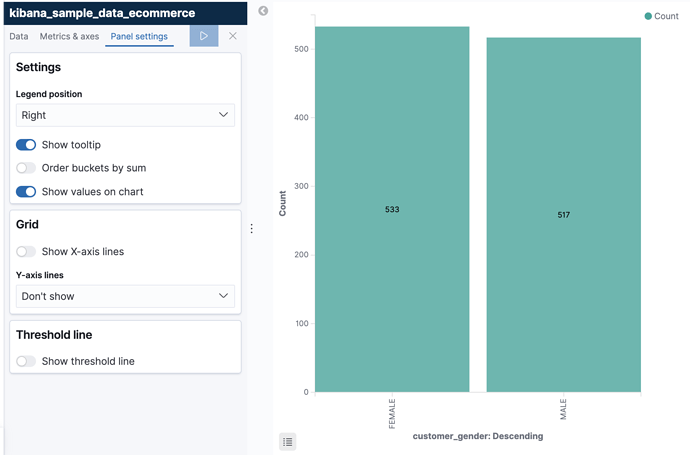

However, I suggest switching to a vertical bar chart, you can show the total values as part of the bar there like this:
