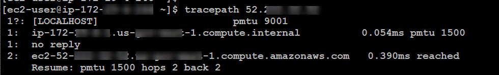

tracepath for both internal and external ip's seem to make it back.
I think it's probably fine to run that way for anything other than production deployments
(I don't think it will be difficult to fix the IP filtering issues at that point, I'm sure there's just a 1-line change in some OS config somewhere that is blocking it, eg net.ipv4.ip_forward = 1 in /etc/sysctl.conf?)
