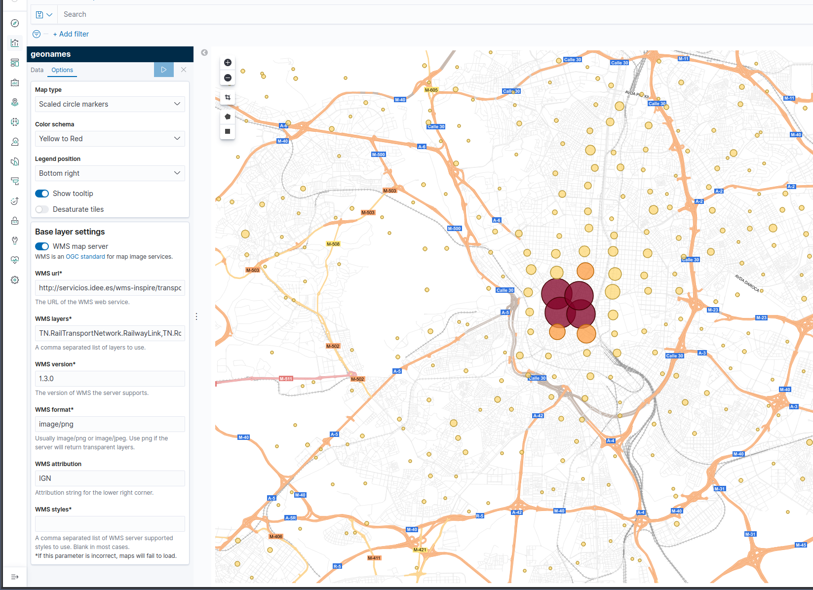

Hi Ibrahim,
Not sure to fully understand your question but if you mean how to have more than one layer being retrieved by the WMS service you need to separate them with a comma.
This is my working example:
This is a sample dataset rendered on top of a Spanish national WMS service with the following details:
http://servicios.idee.es/wms-inspire/transportes
TN.RailTransportNetwork.RailwayLink,TN.RoadTransportNetwork.RoadLink
1.3.0
If on the other hand you refer to render different indexes as separate layers you can't do that with Coordinate Map, but it's possible with Elastic Maps application.
Let us know if this solve your doubt.
