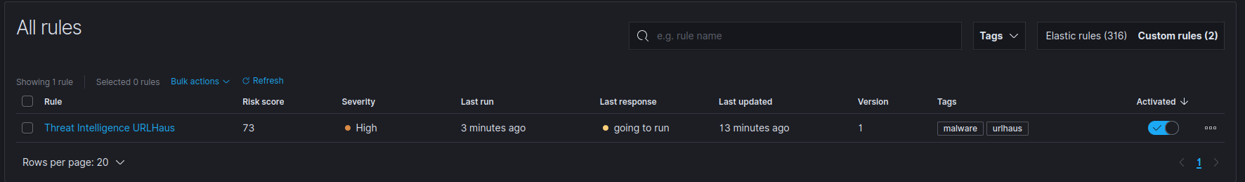

Thanks for your answer @Frank_Hassanabad,
so I deleted the rule and created a new one from scrarch and I didn't see that error anymore, I have configured the rule to run every 5 minutes.
and I waited like 30 minutes, it has been executed and I see the results,
but It steal display Going to run and never display succeeded like the other rules
Should I just ignore this, or there is something wrong ?
Best regards.
Going to run constantly being shown is really the rule itself saying, "I am running right now but am taking a long time to run". We have some open tickets for fixing the status of rules to be more clear about them being in the run state vs. in the "going to run" state as that's obviously confusing.
If it stays in the "going to run" state for a very long time then that means it is running for a very long period of time which isn't surprising since that does a many to many type of join based query which is going to take a while to run.
But it is normal and expected. If you want to break the rule apart using different queries such as querying for a smaller timeframe against your intelligence list that could potentially speed it up but can also have the opposite effect where you end up doing too many queries. But that's kind of up to how you want to tune it when it runs.
I Think that I am gonna try to break the rule into simple queries (without OR), as my cluster went down after 30min running that query, the CPU was at 100% in my 3 data nodes, and went all down
