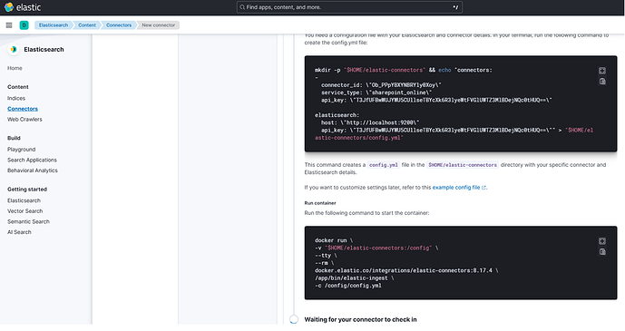

I have used below steps to install and run docker images for Elasticsearch and Kibana.
@Madhu_Challapalli
Here is The Rest of your post ... as a new user you can not put multiple link in a single post
We wanted to use Client Connectors such as SQL Server / SharePoint to perform different searches / web crawling / real time indexing and data migration from SQL to Elasticsearch etc.
Connectors for Microsoft SQL & SharePoint
Self-managed connectors | Elastic Documentation
Tried both Self and Elastic managed connectors using Kibana (Failed with authentication from Kibana UI to Local host)
i tried to run 2nd code to start the container and before run the sync/refresh connector
it was failing with
Critical http://10.54.120.149:9200 seems to be unreachable
any help is greatly appreciated.

Create configuration file
You need a configuration file with your Elasticsearch and connector details. In your terminal, run the following command to create the config.yml file:
Run container
Run the following command to start the container:
Till above completed all steps.
Failing at below step..
docker run -v "$HOME/elastic-connectors:/config" --tty --rm docker.elastic.co/integrations/elastic-connectors:9.0.0 /app/bin/elastic-ingest -c /config/config.yml

[FMWK][06:37:32][INFO] Waiting for Elasticsearch at https://localhost:9200 (so far: 63 secs)
[FMWK][06:37:32][ERROR] Could not connect to the Elasticsearch server
[FMWK][06:37:32][ERROR] Cannot connect to host localhost:9200 ssl:default [Connect call failed ('127.0.0.1', 9200)]
anything i am missing ??`Preformatted text`
ssl: true
Also this is a docker network issue .
When you use localhost inside a container that is localhost to the container it is not localhost of the server so this will never work
When working with Docker, "localhost" inside a container does not refer to the host machine's localhost. Instead, it refers to the container's own network interface. To access services running on the host machine from within a Docker container, one can employ several techniques:
Using host.docker.internal:
This special DNS name resolves to the host machine's internal IP address. It is available on Docker for Mac and Windows and in some Linux environments.
Do a search and learn about this ..
Try
elasticsearch:
  host: "https://host.docker.internal:9200"
Thanks Stephen it worked.
I am able to setup connector.
