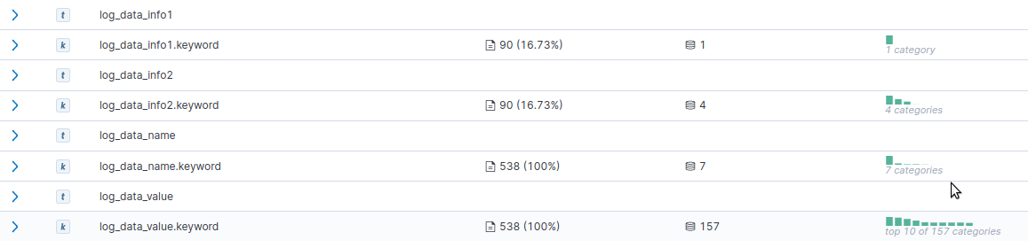

Data allways stack in field.keyword than field
Hi,
I try to install & configure elk 8.3.3 without security on the docker "host" and filebeat on another docker.
All works, i have the live logs, i imported my dashboards, but i have this:
and the problem is because all of my logs are in field.keyword and not field.
I checked my dataView (filebeat-*) and i got this warning:
Mapping conflict
A field is defined as several types (string, integer, etc) across the indices that match this pattern. You may still be able to use these conflict fields in parts of Kibana, but they will be unavailable for functions that require Kibana to know their type. Correcting this issue will require reindexing your data.
I go to http://192.168.66.214:9200/_all/_mapping for see if my index have other type than keyword
"log_data_direction":{"type":"text","fields":{"keyword":{"type":"keyword","ignore_above":256}}},"log_data_info1":{"type":"text","fields":{"keyword":{"type":"keyword","ignore_above":256}}},"log_data_info2":{"type":"text","fields":{"keyword":{"type":"keyword","ignore_above":256}}},"log_data_name":{"type":"text","fields":{"keyword":{"type":"keyword","ignore_above":256}}},"log_data_numerical":{"type":"float"},"log_data_value":{"type":"text","fields":{"keyword":{"type":"keyword"
And it's ok.

  mutate {
    convert => ["log_data_numerical","float"]
I do all step for install & configure filebeat & elk.
I followed this topic https://discuss.elastic.co/t/index-problem-keyword/308112 but nothing.
i do the filebeat setup -e with elasticsearch port
and after i set the logstash port and i launched filebeat.
After i retry but with the logstash port and this command:
filebeat setup --index-management -E output.logstash.enabled=false -E 'output.elasticsearch.hosts=["192.168.66.214:9200"]'
and it's allways the same problem.
If someone have the answer that can help me a lot !

Ohh my god you found the solution !
the problem was there
      index => "%{[@metadata][beat]}-%{[@metadata][version]}-%{+YYYY.MM.dd}"
we need to write it like this
      index => "%{[@metadata][beat]}-%{[@metadata][version]}"
Thank you so much @JLeysens & @stephenb !
