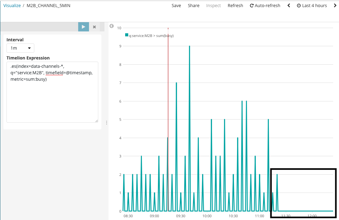

Hey @Diego_Nogueira1, I'm having trouble replicating what you're seeing with 6.4.2. Would you mind seeing if you're experiencing this same issue with this timelion query: .es(index=data-channels-, q="service:M2B", timefield=@timestamp, metric=sum:busy)
Also, are you using the Auto date interval, or are you using a specific interval? Also, what time range are you using?
@Brandon_Kobel,
I have replicated the query you sent but the same problem occurs, only data appears when I change to "4 hours ago".
I also noticed that the discovery has the same problem, contrary to what I said, whenever I enter "15 minutes ago" or "1 hour ago" no data is presented, Both machine and jvm timezone are ok.

Is it just the "Last 4 Hours" option that is causing this? Also, would you mind seeing if you have the same issue when creating a non-Timelion vertical bar chart using the date histogram aggregation?
