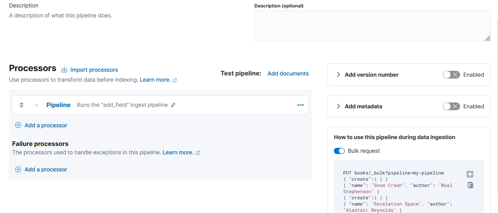

Attached, I report the field to be processed and the screenshot of the definition of the pipeline logs-trend_micro_vision_one.detection@custom.

In order to debug you will need to provide a full sample document in JSON and the full pipeline....
You can test with _simulate
And also use verbose
Then in addition there could be a mapping error...
So get a raw event and try to me manuallyPOST it to the data stream

I tested from GUI with 'Test pipeline'. No errors were found.
No doc containing the data I'm interested in is written to datastream.
How can I send you the full document? I can only attach images and the document is very long.
Unfortunately the GUI test pipeline that may mean the pipeline works but when the doc is written there is mapping conflict and it is not written because it is rejected.
You need to try to POST a document from the dev tools.
See my instructions above.
That was s how you are going to need to test if you can not prove s sample document and full pipeline

Also, here the screenshots of the ingestion policies:
It would be better if you could post the pipeline text instead of images...
I have some other things to do if I get a chance I will look in the meantime you should try to post the document... Which will call the pipelines and see what happens
add_field pipeline:
"json": {
"field": "event.original",
"target_field": "details",
"if": "ctx?.trend_micro_vision_one.detection.product.name == 'Vision One Container Security'"
"json": {
"field": "details.rawDataStr",
"target_field": "rawdetails",
pipeline logs-trend_micro_vision_one.detection@custom pipeline:
Processors
"pipeline": {
"name": "add_field"
Failure processors
"set": {
"field": "pipelineerror",
"value": "details.rawDataStr"
Is there a other
