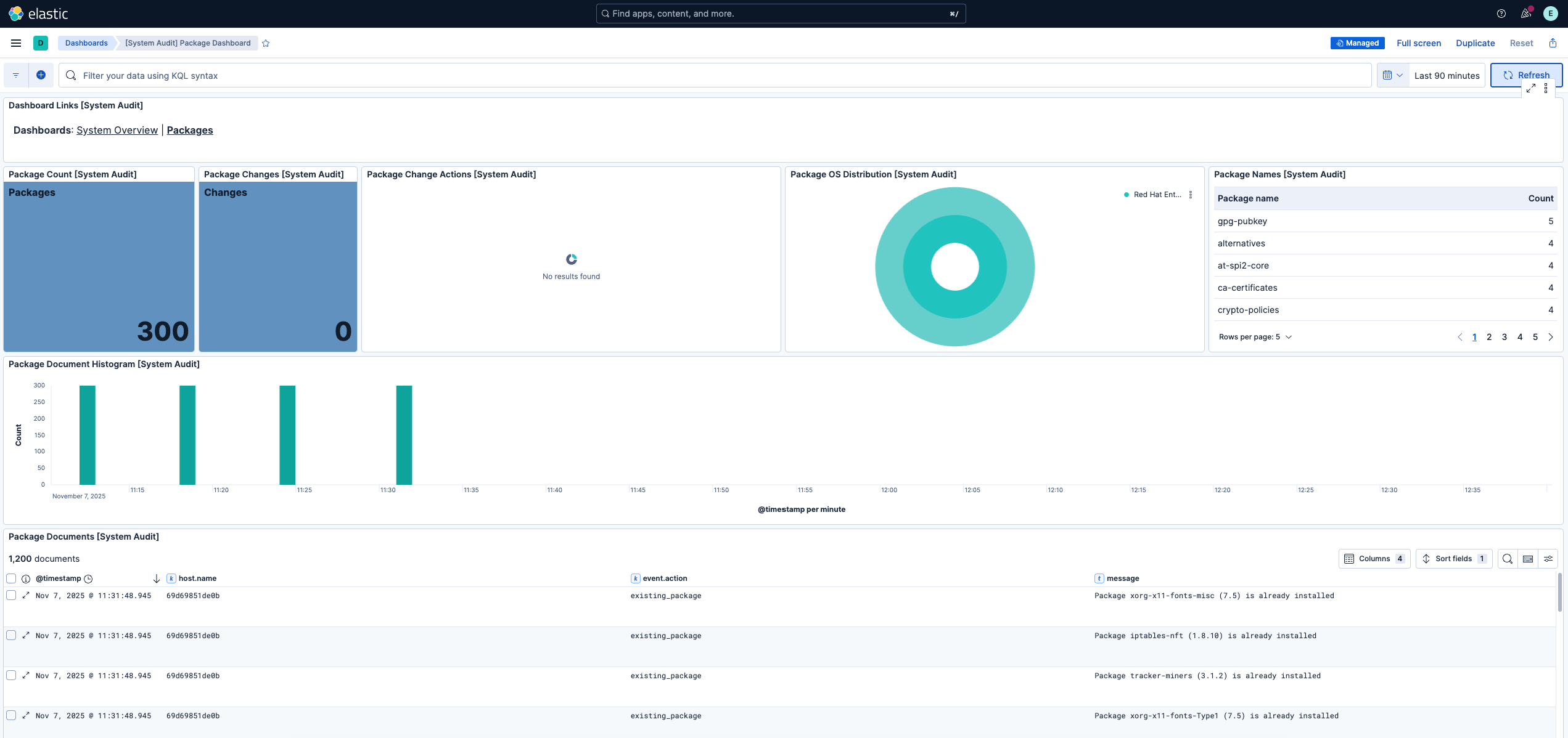

In Kibana, I can see the following:
Test sequence (waited >15 min; period: 2m):
dnf install -y telnet vim
dnf remove -y telnet vim
The Elastic Agent logs show no errors — everything looks normal, but no package install/remove events are being collected.

Question:
I don’t see any DNF install/remove events — does the system_audit.package stream actually support collecting them on Rocky Linux 9.6, or does it only report the current package state?
