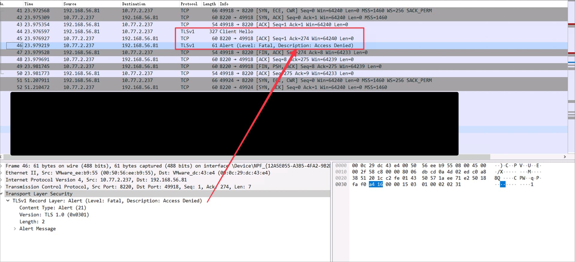

Then I captured traffic using wireshark, things start to get interesting now:
Chrome requesting HTTPS /api/status , working fine:
Elastic-Agent Enroll, failed immediately even before Server Hello:
Comparing ClientHello and Server supported TLS protocol, seems all good:
Left-one is client-hello, right-one is server-hello, so this comparison should result in no issue.
So there must be something wrong and a bug might be here.
BTW, I've confirmed that there is NO PROXY set in the environment.

Update 1: fleet-server debug logging: elastic_agent.fleet_server [elastic_agent.fleet_server][error] http: TLS handshake error from 10.77.2.254:51858: EOF
So either side must be something wrong in TLS handshake protocol.
I'll continue debugging until I'm tired.
Update 2: I tried to reverse proxy fleet-server using Caddy to eliminate the range of troubleshooting, and curl returns 200 as expected, but same TLS access denied alert occurred when using Elastic Agent after client-hello reached reverse proxy server. So I guess the problem is from client side.
Then I set GODEBUG=http2debug=2 to check if it could dump http/2 frame data, of course, nothing output.
End: ESET blocked my website access without any alert.
