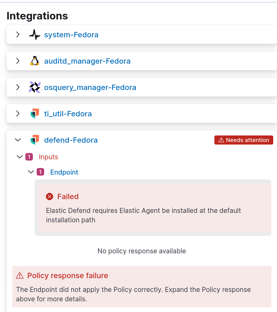

but it still complains Elastic Defend is not at the default path:

I can manually edit the "endpoint-security.spec.yml" file and remove the following:
        - condition: ${install.in_default} == false
          message: "Elastic Defend requires Elastic Agent be installed at the default installation path"
After restarting elastic-agent, it is green, even without installing elastic-agent into /usr, but after rebooting there seem to be SELinux problems that are not logged, maybe later will try finding what is blocked without the "dont audit" rule.
The Elastic Defend integration does not work if it is not installed on one of the default paths.
If /usr is read-only in your system, then you need to install it using the tar.gz distribution, which will install under /opt/Elastic.
But I do use the tar.gz option already.
That "sed" line is used on the elastic-agent executable that is found when extracting the archive.
What I believe running the elastic-agent install does it that it copies itself to /usr/bin/ and to /opt/Elastic. With "rpm-ostree admin --hotfix" I can make /usr writable, but that seems to be only a part of the issue.
By editing the .yml file I removed the check that it is in the default install path, but if you look at my "ps aux" output, then you can see that Elastic Agent is actually running in /var/opt, not /opt.
This is expected since /var/opt is the actual directory on Silverblue, but /opt is a symlink to /var/opt.
TL;DR
Elastic Agent is installed in /opt, but due to how Silverblue is made it thinks it is not!
Yeah, I'm not sure this will work, you may need to bind mount /var/opt into /opt to make it work.
It is a limitation fo the Defend integration.
