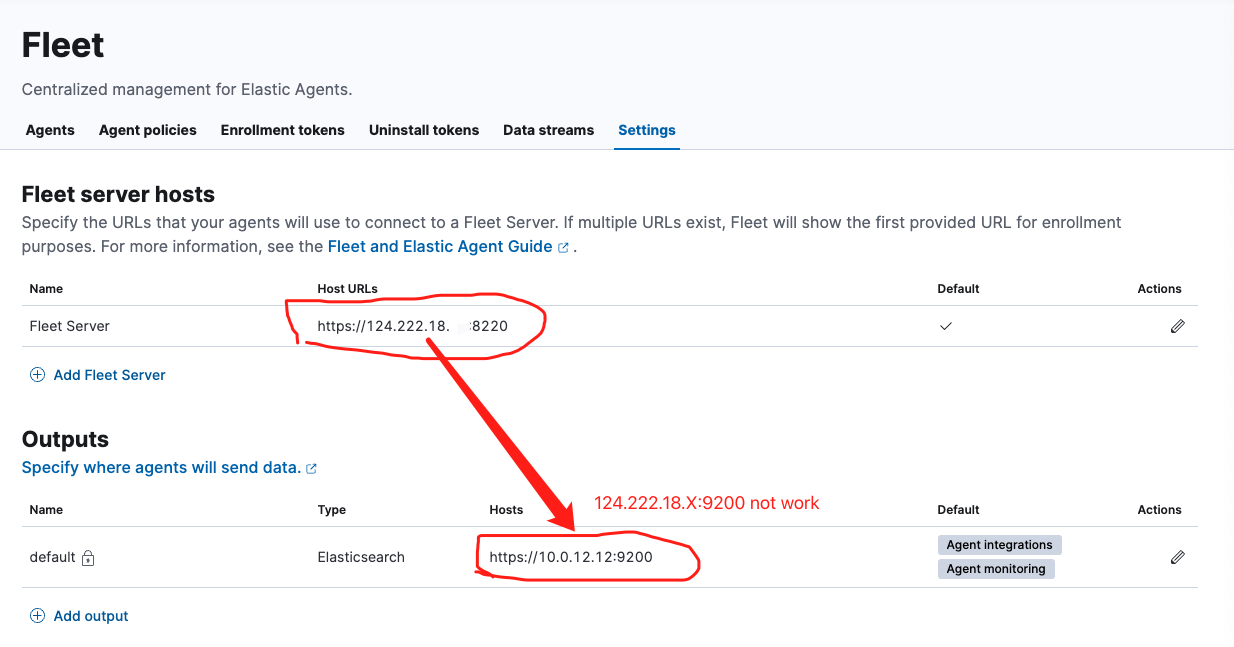

Elastic Agent successfully connect to Fleet Server but Elasticsearch did not receive data! bug
OS
lsb_release -a
No LSB modules are available.
Distributor ID: Ubuntu
Description:    Ubuntu 22.04 LTS
Release:        22.04
Codename:       jammy
install Elastic
wget -qO - https://artifacts.elastic.co/GPG-KEY-elasticsearch | sudo gpg --dearmor -o /usr/share/keyrings/elasticsearch-keyring.gpg
sudo apt-get install apt-transport-https
echo "deb [signed-by=/usr/share/keyrings/elasticsearch-keyring.gpg] https://artifacts.elastic.co/packages/8.x/apt stable main" | sudo tee /etc/apt/sources.list.d/elastic-8.x.list
sudo apt-get update && sudo apt-get install elasticsearch
elasticsearch.yml
network.host: 0.0.0.0
xpack.security.authc.api_key.enabled: true
systemctl restart elasticsearch
install Kibana
sudo apt-get update && sudo apt-get install kibana
kibana.yml
server.host: "0.0.0.0"
sudo systemctl start kibana
Fleet Server
install server on this host (124.222.18.X)
sudo ./elastic-agent install \
  --fleet-server-es=https://10.0.12.12:9200 \
  --fleet-server-service-token=AAEAAWVsYXN0aWMvZmxlZXQtc2VydmVyL3Rva2VuLTE3MDMzMjUzOTMyNjE6b05TMFBjYTVTRTZ3UjZpN1FiN2N2UQ \
  --fleet-server-policy=fleet-server-policy \
  --fleet-server-es-ca-trusted-fingerprint=00c7a760b4ed7747ca7b64e122b2f6ffd230118ccb6981c26121edd3337af0eb \
  --fleet-server-port=8220
---> Elastic Agent has been successfully installed.
Install the agent on my own personal computer(Mac)
sudo ./elastic-agent install --url=https://124.222.18.X:8220 --enrollment-token=aXBraWxvd0JXbk5WVXlibi1DQXM6R1dRWTlUazZSclNybGQ2S0RWdF9qUQ== --insecure

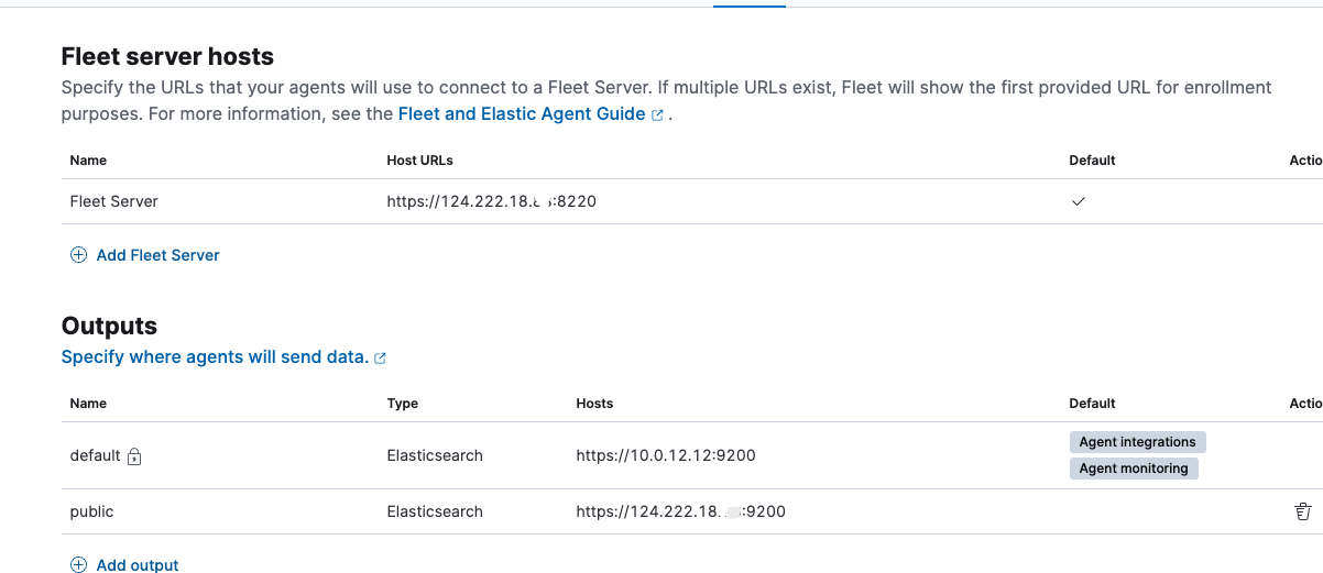

Elasticsearch did not receive data:
still not work:
Can you provide any logs from elastic-agent?
I think this is a certificate issue where the cert that ES generated for itself does not match the IP address that the agent is using, we can confirm this with log messages.
If that's the case you will need to create a new cert for ES that lists multiple IPs.
