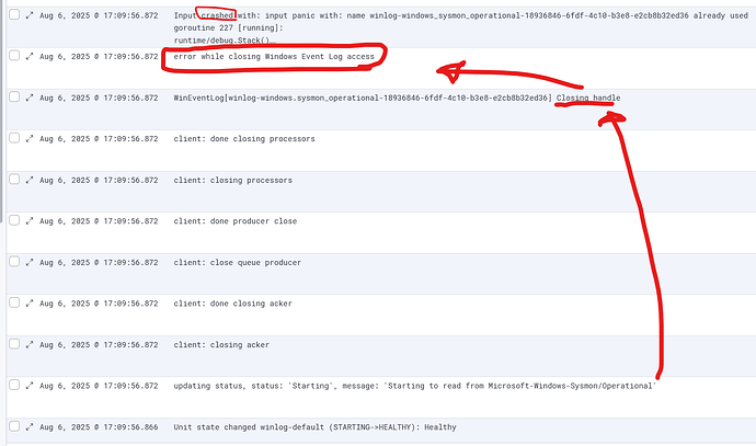

EDIT:
Some extra information.
Seems like the handle is not closing.

FYI, I think you’re seeing the bug that this PR addresses: Fix panic in winlog input by faec · Pull Request #45730 · elastic/beats · GitHub
Hallo,
thank you I am aware it was due to a bug.
