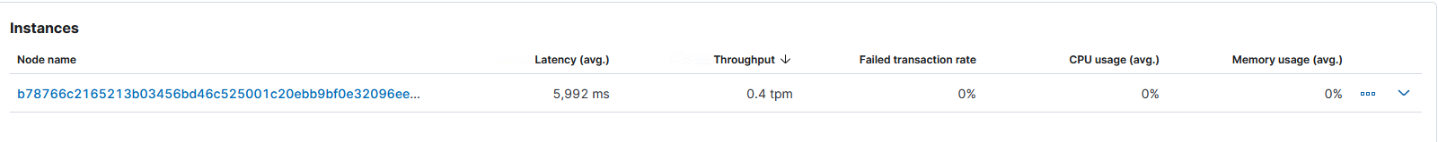

I have implemented both APM Agent and OpenTelemetry Agent forward data to APM Server, but all the metrics data have this issues: No Pod metrics, No JVM metrics
This seem relate to these field metricset.name, metricset.samples.name and metricset.samples.value, they wrapped on the metric data inside. Please see the attached images.
