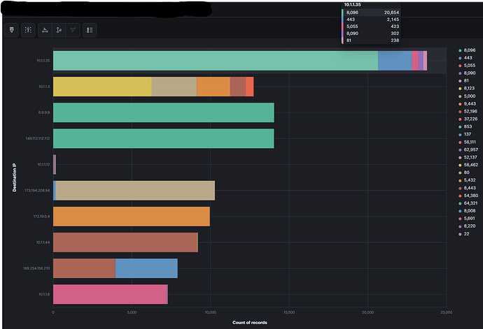

The "5.3 - Lens" questions use the visualizations from labs 5.1, 5.2 and 5.3. Question 5.3-1 uses the visualization you made in lab 5.1. The issue seems to be your time range. If you select "Day-0" from the drop down and make no other changes to the timepicker, you should get the correct answer. By setting your time range to "Day 0 to Now", you have inadvertently included data for all the labs and capstone. The "Day-0" time range is Aug 1, 2018 @ 00:00:00 through Aug 1, 2018 @ 23:59:59 if you would like to double check it or set it manually.

The labs themselves mention selecting "Day-0", but I agree that it should be stated in the question as well.
For 5.3-2, it wants a singular count. Looking at the same visualization you used for question 5.3-1, when you hover your mouse cursor over the bar for the top IP, it will show you a count for each destination port that IP address sent traffic to. The count of the highest one is your answer.
In the case of my example screenshot below, the answer for Q5.3-1 would be port 8096, and the answer for Q5.3-2 would be 20,654.
Note: This is example data that does not correlate to the actual answer in the course.
