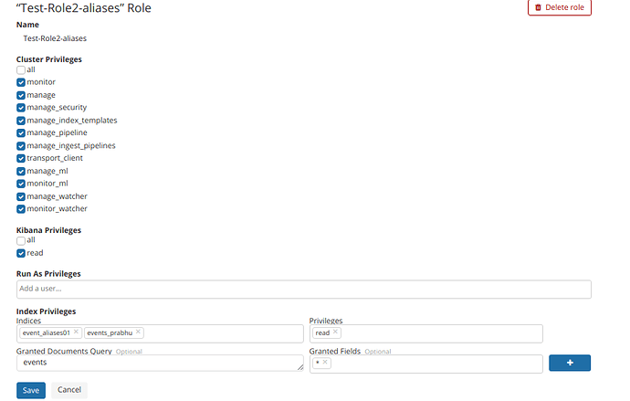

Below is my xpack user privileges details,
Could you please help me to fix this issue.
Please don't post images of text as they are hard to read, may not display
correctly for everyone, and not searchable. Also, please don't post unformatted logs as these are very hard to read.
Instead paste the text and format it with </> icon, and check the preview window to make sure it's properly formatted before posting it. Also try and describe your issue clearly with words or using example API calls, in your case the output of GET /_xpack/security/role/Test-Role2-aliases
This makes it more likely that your question will receive a useful answer.
It would be great if you could update your post to solve this.
Your "Granted Documents Query" needs to be an actual Elasticsearch Query in JSON format.
"events" is meaningless there.

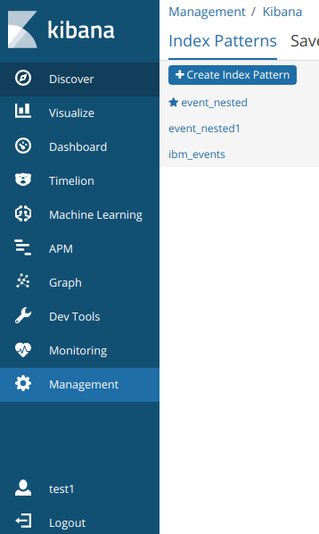

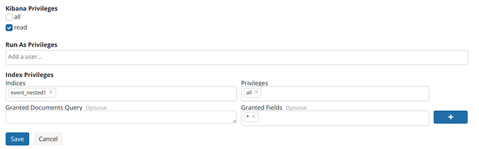

Thanks Christian, i have tried but no luck, below screenshot has the details,
test1 user has restricted to events_nested1 index pattern, but when loggd in with test1 user we can see three index pattern are visible.
If you are looking to restrict access to index patterns and visualisations/dashboards and not just the data in the indices, you should look at Kibana Spaces and how you can use this together with security. This will however require an upgrade to the latest version.
