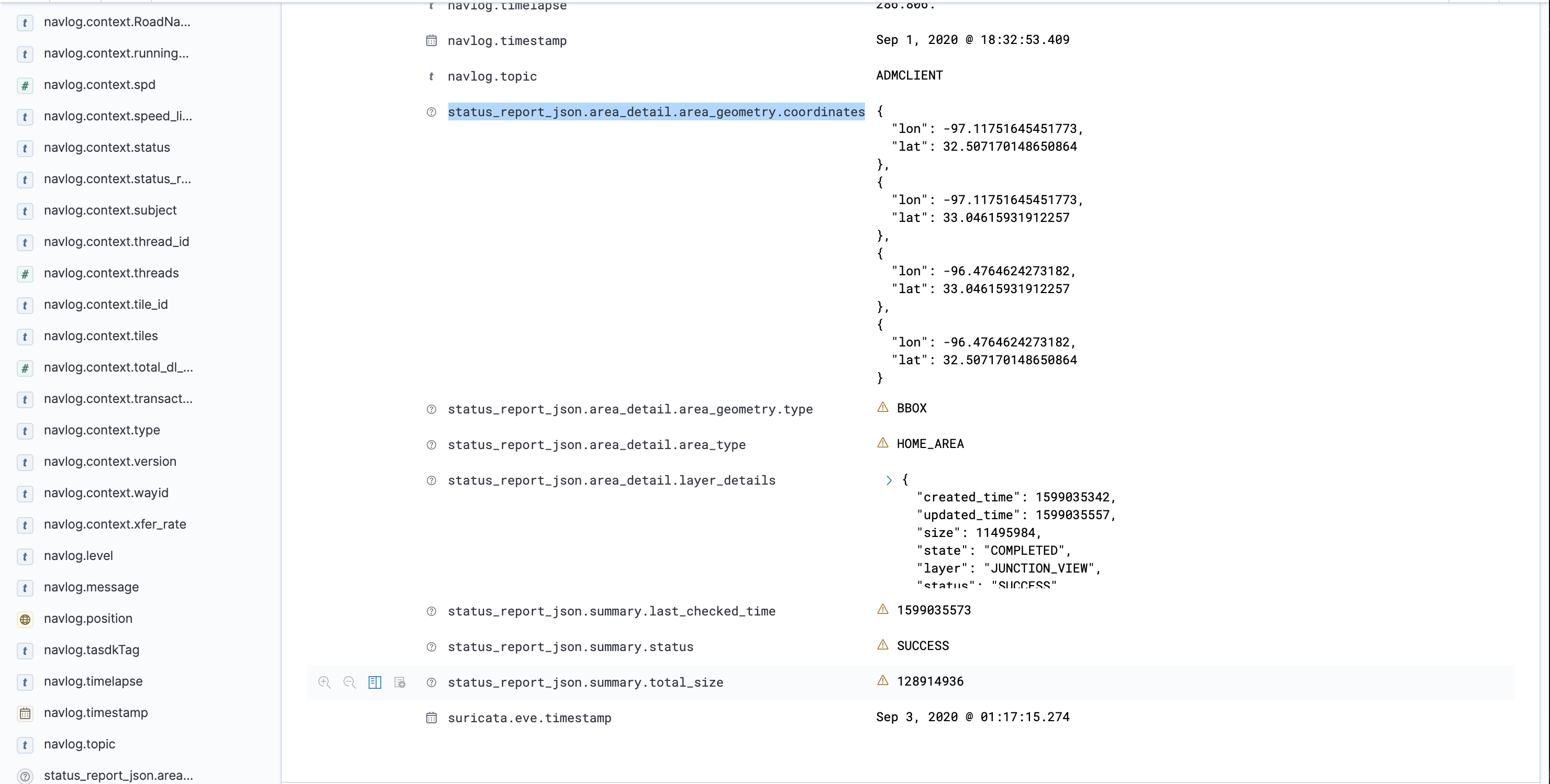

  1. I noticed in the TABLE view, the JSON processor does not decode the JSON if there is a list of complex structure. In the example below, there are 2 fields that was not decoded: a) coordinates, b) area_details. I would like to find out if this is a known limitation or there is something that can be done to fully decode these fields?
  2. I also noticed that in the JSON view, the JSON string has been decoded correctly. This is different from the TABLE view, where I noticed some failure (Please refer to the picture that I capture and uploaded here)
  3. Is the above target_field ("status_report_json") will be created by the JSON processor without being predefined. Is it expected? I try to define this field inside the fields.yml, but this change does not work - Java execption error!
