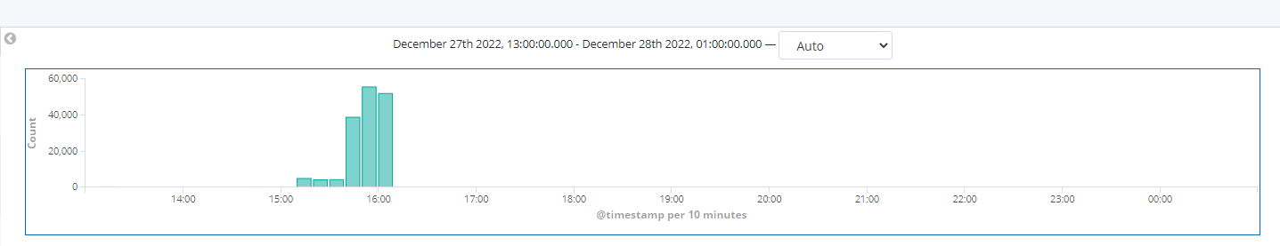

Elasticsearch, Kibana does not work
I have an issue with Elasticsearch. After restarting ubuntu, Kibana does not show any logs.

  1. Does your ES is up and running?
    Use curl to test: curl -u user:pass http://host:9200
  2. Any trace in ES logs?
  3. Can Kibana host reach ES? If is on the same server, no need to check
You miss setting for logging in kibana.yml
Which version of Elasticsearch are you using?
Change the IP address to 127.0.0.1 (localhost).
I do not see any security set up in your Elasticsearch config. Can you comment out these lines and see if that makes any difference?
Thanks for reply.
this is kibana.yml
It still logs the data under /etc/var/log/elasticsearch

Kibana and ES are on the same server.

there was no information since this day.

PAN-OS send logs to 5515 port.
tcpdump -i any dst port 5515
While I'm listening to this port, I can capture packets coming from pan-os.
Solved
Would be nice to explain briefly, what was cause and how you solved.
The issue was in nginx. I have configured it again like that.
