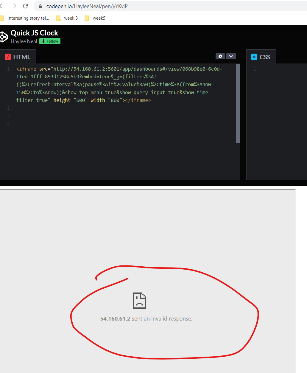

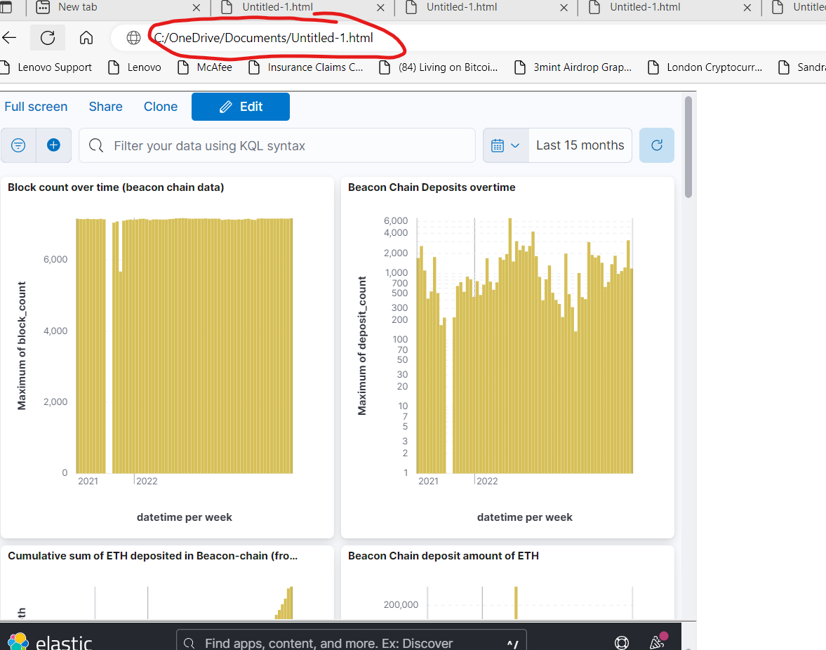

Having some issues rendering the embedded iframe code link from kibana to other platforms. For some reason it works when I run it on a local static file, but does not work when I test it on public platform such as codepen or hackmd.
Is there some issue I am not aware of ?
Here is the link:
works on local static file:
does not work on public websites:
