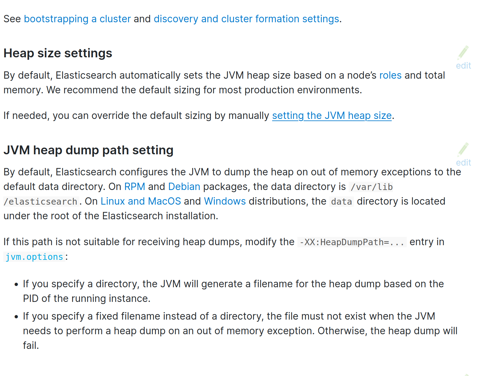

This article well explain the problem.
Does somebody knows how i can delete the memory load in coordinating_in_bytes to reduce it to an acceptable value ?

Ok i've search how to increase the heap size and i came across this article from Elastic:
Then i found how docker start elasticsearch with the following command:

Ok maybe i see what setting to change in order to increase the heap size.
In the docker compose file that i use to launch the docker containers:
There is a setting:
environment:
      node.name: elasticsearch
      ES_JAVA_OPTS: -Xms512m -Xmx512m
Maybe i need to change -Xmx512m value to -Xmx512m to -Xmx2g -Xms2g like they said in this elastic article Advanced configuration | Elasticsearch Guide [8.6] | Elastic.
