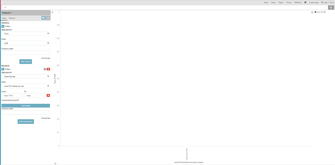

Hi I have the following data:
and when I make a visualization of this info I get nothing:
Many thanks!
This is because it doesnt show me decimal figures
Decimal numbers should work fine. This test data doesn't have timestamps so I can't do the exact same as yours, but you can see the sum of my decimal values are shown on the chart.
You can click the little arrow at the bottom of the page to get to the data table and see if it just has 0.
