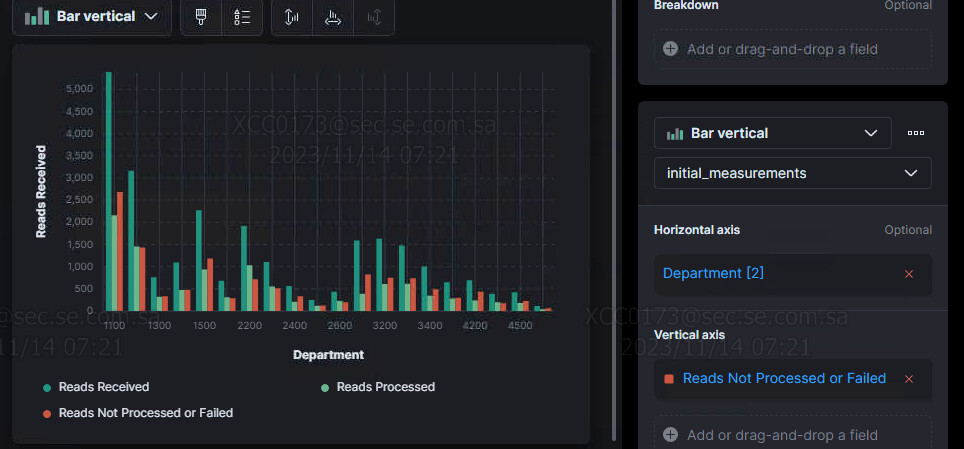

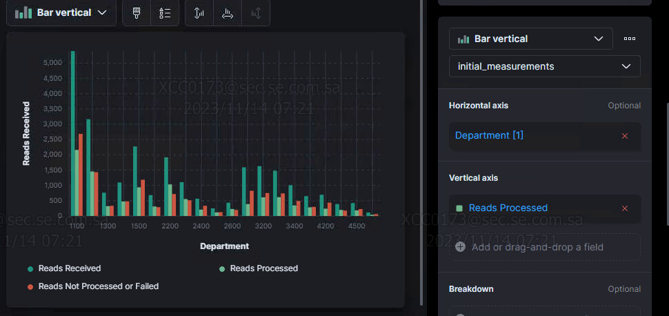

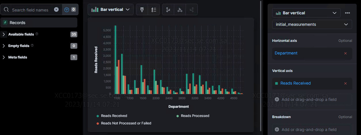

Thanks for your response. Please find the below screenshot for your reference.
Thanks.
Ok got it, so you have the same horizontal axis. Yes at this case, it makes sense to be able to navigate to Discover. I will discuss it with my team and create an enhancement request.
What you could do now is to move the Reads not Processed or failed metric to the first layer. They have the same horizontal axis so you can have 1 layer with 3 metrics. In this case, the navigation to Discover will be displayed.
