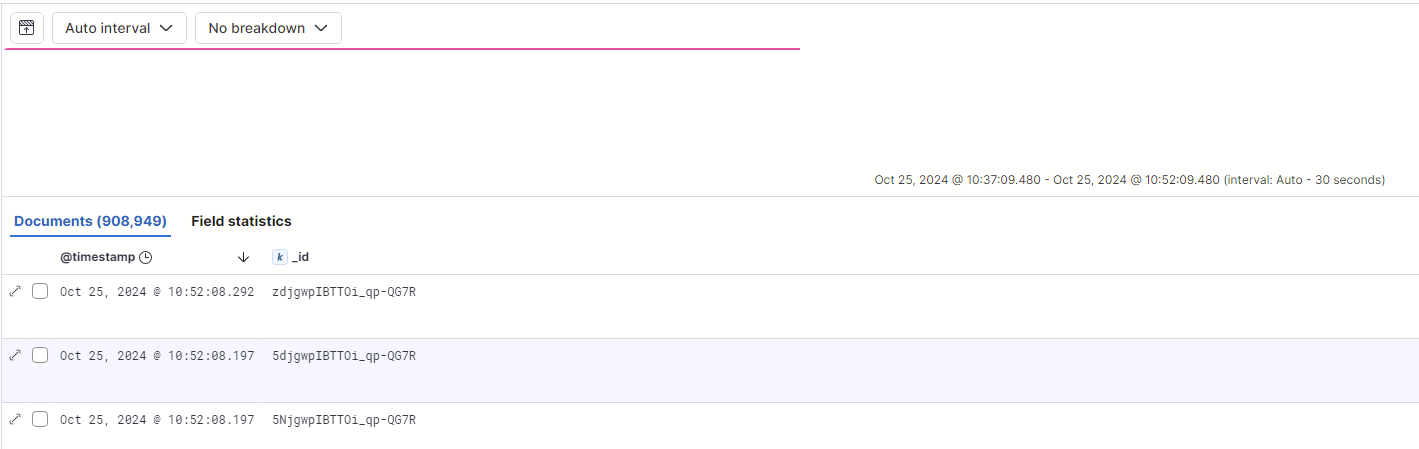

After a migration from version 7.17 to 8.15.3, I have an issue with some visualization.
For example in the discover, the chart is not working anymore:

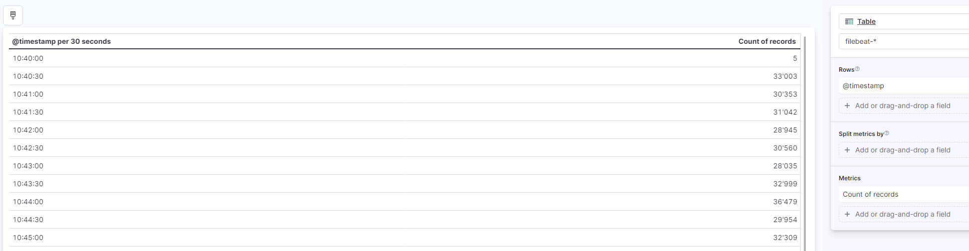

If I go on lens and display the result by table I got the data:

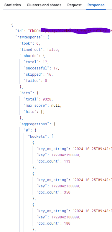

If I inspect response I got results:

I did an inspection of the query and reply:
The request:
And the reply:
Only the chart is broken the document are retrieved:
When I drill down into Lens:
If I switch to table:
