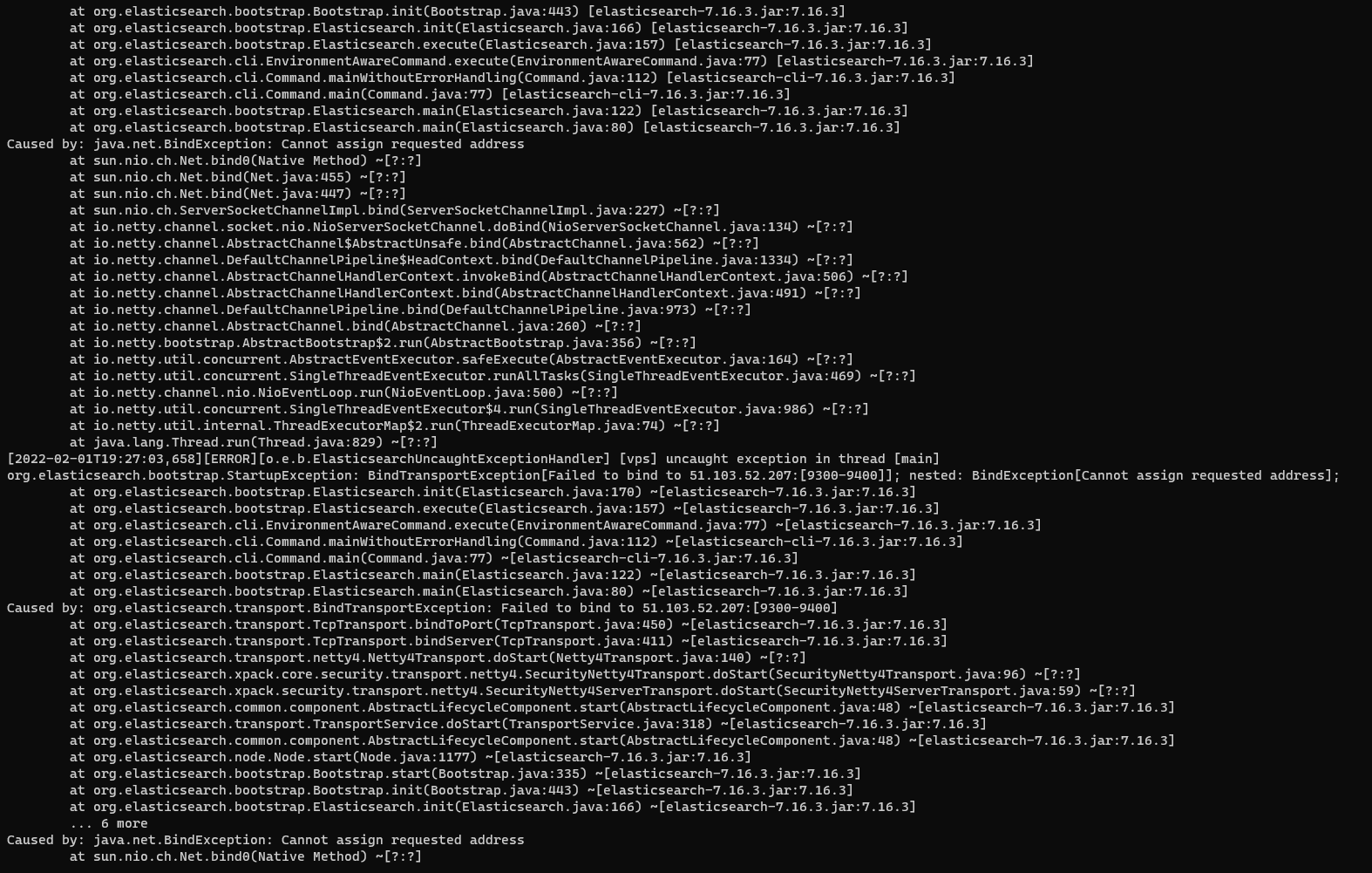

Failed to start Elasticsearch [7.16.3] [Ubuntu 20.04]
Hello there,
I have installed Elasticsearch trough the apt on my vps ubuntu 20.04, i just followed the installation guide from here : Install Elasticsearch with Debian Package | Elasticsearch Guide [7.17] | Elastic
I checked all was running with "curl myip:9200", it returned that all was working fine...
But a few time later, my service wouldn't start normally... i tried to do so many things by searching a solution on the web...
It's the first time i use Elasticsearch but i need it to install magento 2 so i hope someone can help me pls !
There is my error i got on the status :

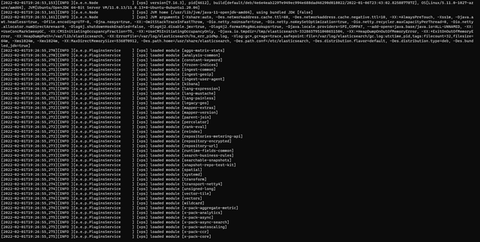

There is the logs :

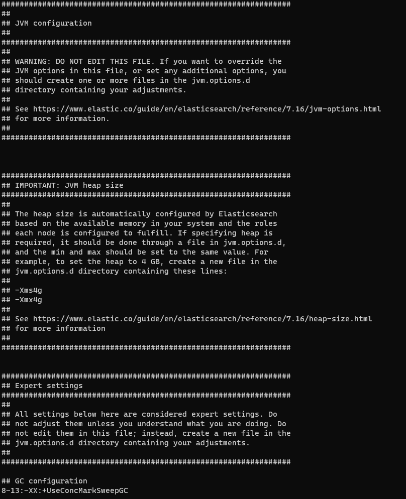

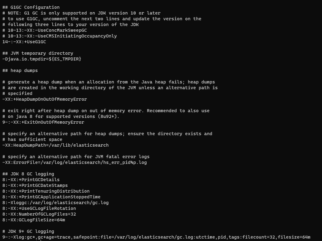

There is the jvm.options :

Welcome to our community! :smiley:
Please don't post pictures of text, logs or code. They are difficult to read, impossible to search and replicate (if it's code), and some people may not be even able to see them :slight_smile:
Your problem is "can't bind to your ip address".
I binded the ip adress of my vps in my elasticsearch.yml, i just hid it

What @rugenl is saying is the error in that last screen shot (and please do not use screen shots) Indicates a bind error... like the address is already take or can not bind

I understand where the problem is coming from but i ​don't understand what am i supposed to bind in my config file
my vps is hosted by micisoft azure and they gave me a public ip adress and in the config file i binded this adress at "network.host"
but it failed to start with this config...
but when i bind my localhost adress it's working so i'm lost pls explain me

Well I am not an expert on azure but in GCP you bind to the internal NIC / Address .. that Internal Address is then in turn bound to the external address by GCP networking... then I can access Elasticsearch via the external address.
example in my GCP console, I this
10.168.0.81 (nic0), 35.2XX.5X.1XX (external)
and I bind to 10.168.0.81 or when I run
ifconfig
ens4: flags=4163<UP,BROADCAST,RUNNING,MULTICAST>  mtu 1460
        inet 10.168.0.81  netmask 255.255.255.255  broadcast 0.0.0.0
        inet6 fe80::4001:aff:fea8:51  prefixlen 64  scopeid 0x20<link>
and I can bind to _ens4_ the network interface name ... see Here
I suspect Azure works similar

well, i'm not an expert of network but i think azure is similar yes, when i run ifconfig i have the same adress on inet line as my private adress configured on azure panel
then i have a second paragraph always in ifconfig that show my localhost adress on inet line
sry mate but i was a bad student in networking course and i don't know what i have to bind so in my config (for me it's not "ens4" but "eth0")
i tried to bind my external adress in network.host and the service cannot start
can you explain your last sentence pls ?
Elasticsearch, and any other service, only can bind to IP address that are available on the host, which is not your case.
Normally on cloud provider when you get an external IP address, this IP address will be associated to your instance, but will not be available directly to the host, so, for the operating system this IP address does not exists.
What happens is that when the cloud provider receives a connection on the external IP address associated to your instance, it will redirect the connection to the private IP address of your instance and is on that private IP address that you should bind Elasticsearch or other services.
Try to change your network.host configuration to use your private IP address or _eth0_, both should have the same effect.
