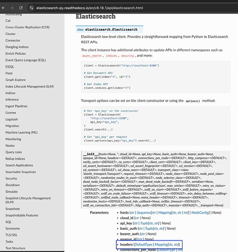

@elasticforme it is possible to add headers to the Python connection, as covered here in the Python client documentation:
just for someone who might be looking this.
I did this in python
script_name = os.path.basename(sys.argv[0])
es = Elasticsearch(elastic_hostnames, http_auth=(elastic_admin_user, elastic_admin_passwd),
                               request_timeout=120, max_retries=3,
                               retry_on_timeout=True,
                               sniff_on_node_failure=True,
                               headers={"X-Opaque-Id": script_name})
and I now has headers show up as python script name.
