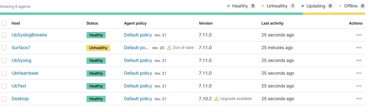

After upgrading Elastic-Agent to 7.11 Windows machines get a 'Unhealty' state in Fleet.
Even installing Elastic-Agent on a clean installed Windows machine will get this issue.
The 4 Ubuntu servers are doing well.

For what its worth, I was able to get back to a "healthy" state on my fleet windows 10 workstations by disabling the system load metrics on the policy and then restarting the elastic agent. Not sure what's wrong with the load collection on Windows but this does appear to fix the issue.
@craigothy i would say this is the correct approach here, issue was worked on and i fix will be present in next release,
system/load is not supported on windows. nothing changed here but agent is just more sensitive to failures of metricbeat from this version on. so before it was failing and agent was ok with it, now it's not ok and complains.
from next version on, system/load will not be applied on windows agents
