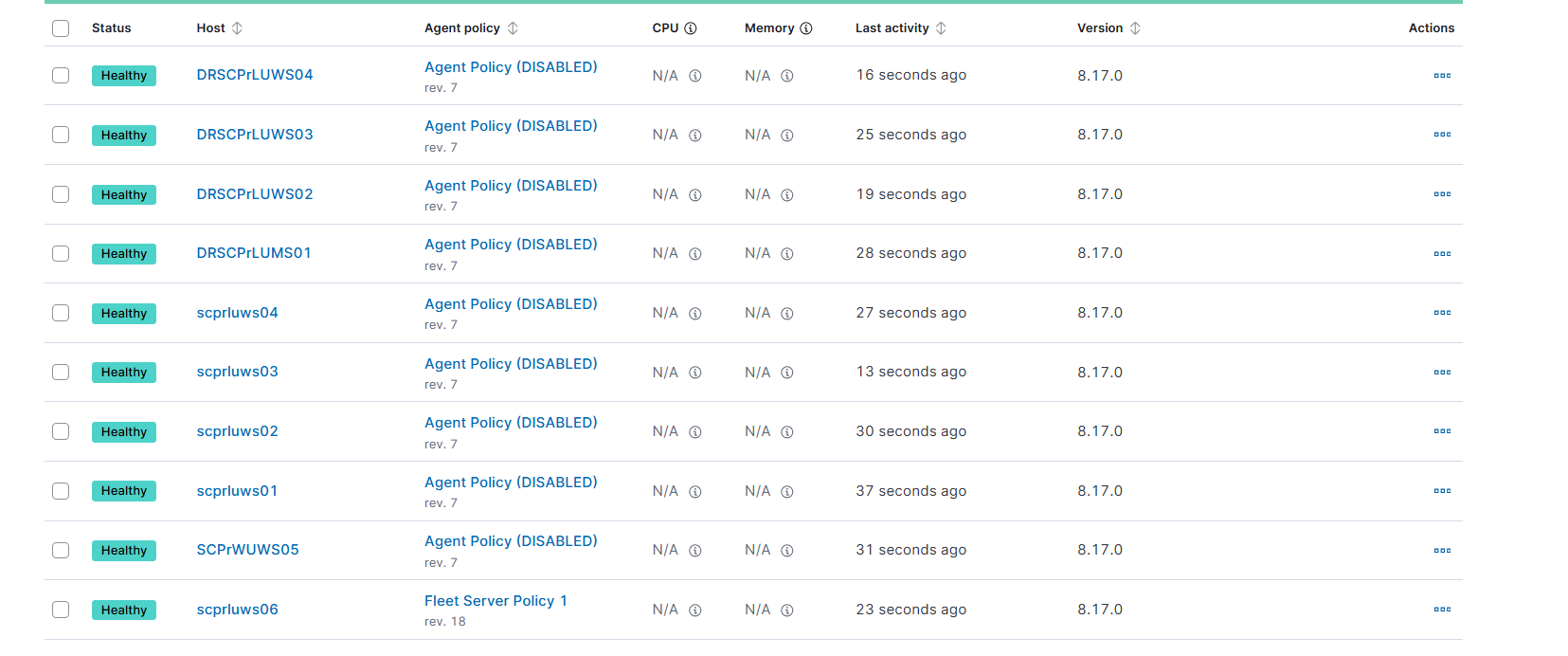

I’m replacing Metricbeats with Elastic-Agent on multiple servers so i can manage them through UI, but I noticed that some options are not working like "Agent logging to files" & "Agent log level", you have to disable them from the “/Elastic/Agent/elastic-agent.yml” file.
Is there something wrong with my configuration?
Stack version : 8.17.0
OS for ES host & Fleet server : Linux
Elastic agents OS : both Windows & Linux
Note : the below configuration did not work untill i put this line in the .yml file : logging.level: error
All the below agents are connected to the above policy “Agent Policy (DISABLED)”, yet they are still logging to files.
