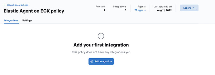

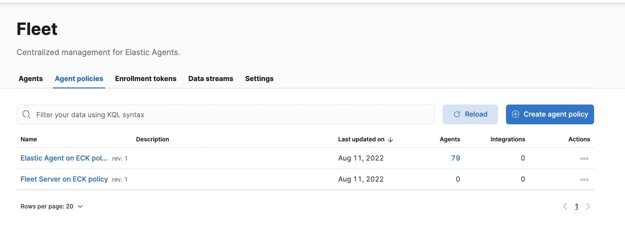

Besides this, the integrations that I have defined in xpack.fleet.packages: are not being shown either in the Kibana UI, check on the screenshot below, and there is nothing in the logs that can help me debugging this.
