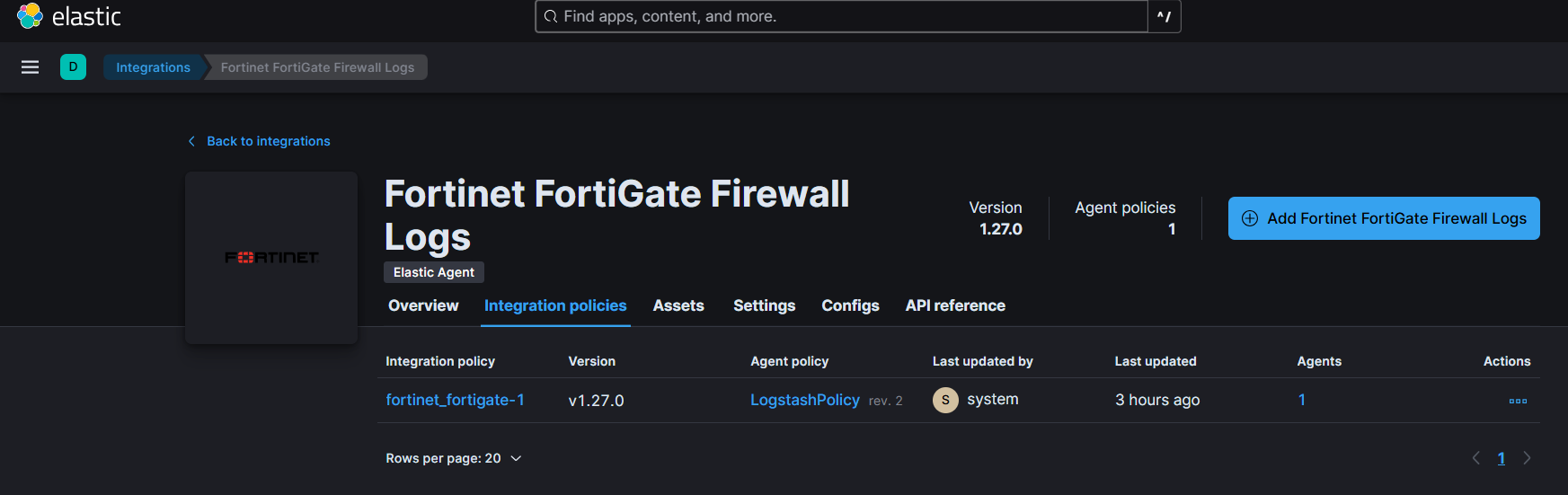

I have installed the “Fortinet FortiGate Firewall Logs” integration.
I did the respective configuration
The datastream was created and I am receiving logs normally.

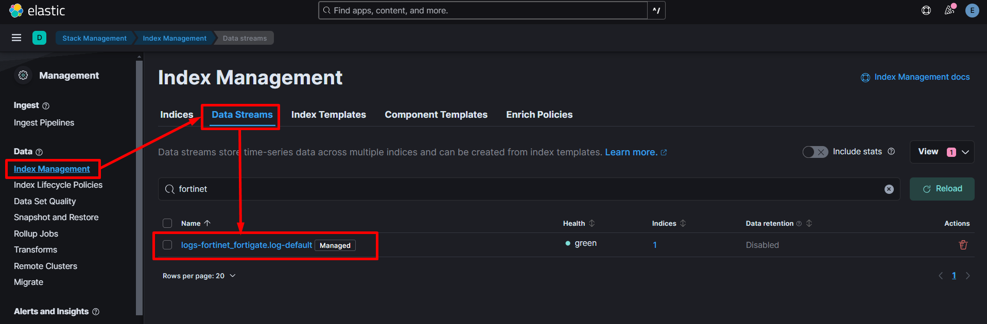

My problem is that it took a policy called “logs” and I need to apply an index life cycle of 1 day and for obvious reasons I cannot modify the “logs” policy because it would affect the other datastreams, I need to apply a policy only for Fortinet.
If the ILM policy is associated to the index template, then I go to the fortinet index template but I have no idea what to modify to apply the ILM I created manually called “Fortinet-policy” which removes the index in 1 day.
I also see that there are some “component templates” and not knowing what they do or what they are for I am worried about moving something that generates problems to the ingest that at the moment works fine.
Thank you for your help
The workflow for customizing the ILM policy of an existing integration is available here: Tutorial: Customize data retention policies | Fleet and Elastic Agent Guide [8.16] | Elastic
