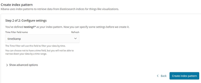

But now I have another issue. I am able to see index in kibana but I am not able to create the same index pattern.
Eg: I have sent data to index testing1. But when I am trying to click on "create Index" button, It is not creating the index.
I restarted Kibana service also but no luck :frowning:
