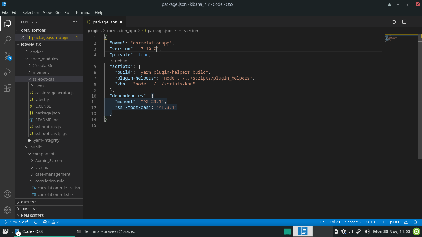

When I test the app locally it works fine, but after creating build and installing the plugin, it gives error - "Error: Cannot find module 'ssl-root-cas'"
below is my package.json file.

  "dependencies": {
    "moment": "^2.24.0",
    "ssl-root-cas": "^1.3.1"

First, can you confirm the package you're referencing is in the node-modules folder of your plugin?

Hi @clintandrewhall,
Yes the package is present in node-modules
I went through the link you had shared to create the build & yes i have followed the same methods.
