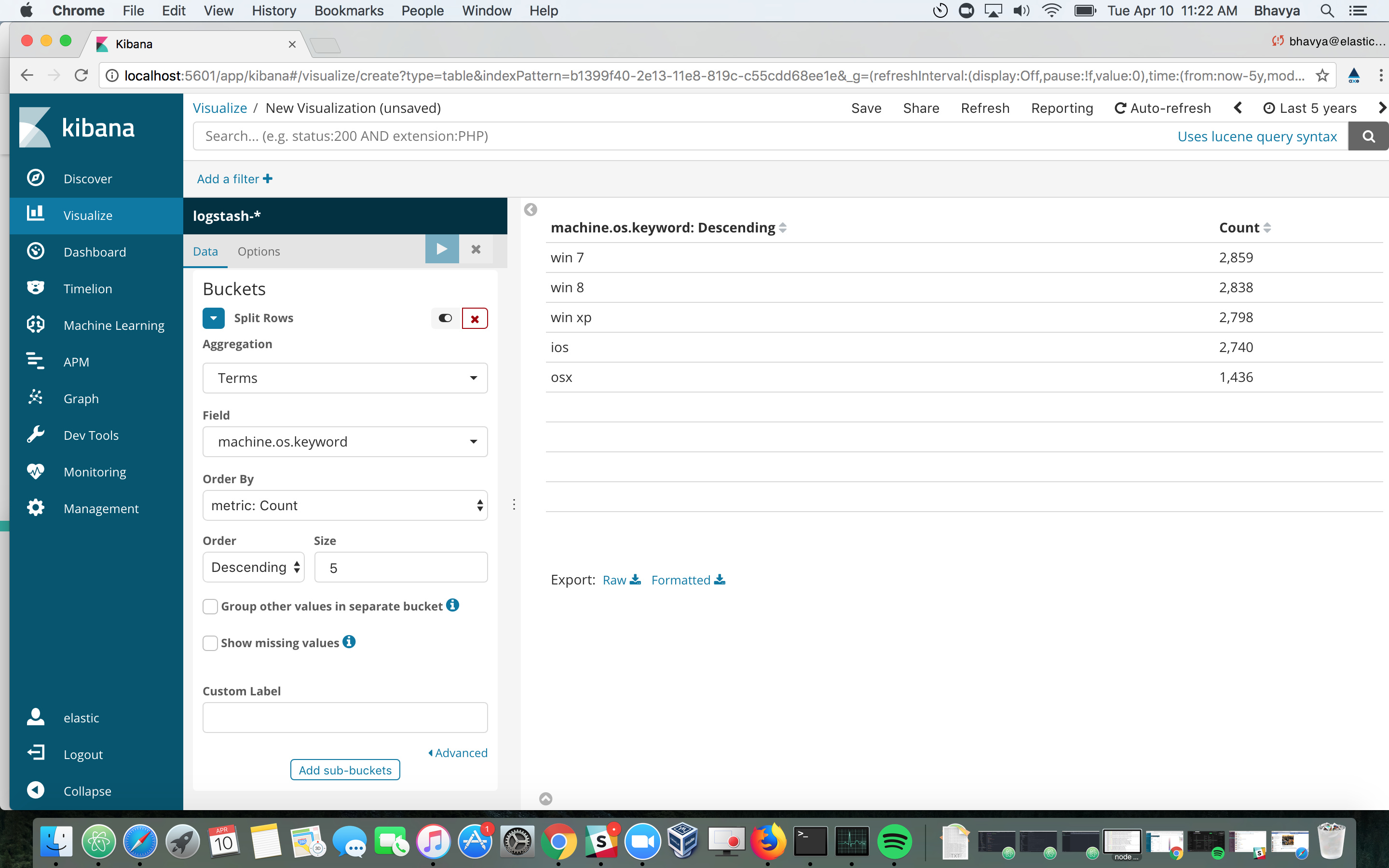

So - dashboards can contain two kinds of objects.
  1. Saved searches: you can do a search in discover, save it and then add it to dashboard. Here I did a search on response:200 and then saved it.
  2. Visualizations: you can create a visualization and then add it to a dashboard. Here I created a data table on terms aggregation on machine.os
  1. You can see that the dashboard here has both of them on it.
