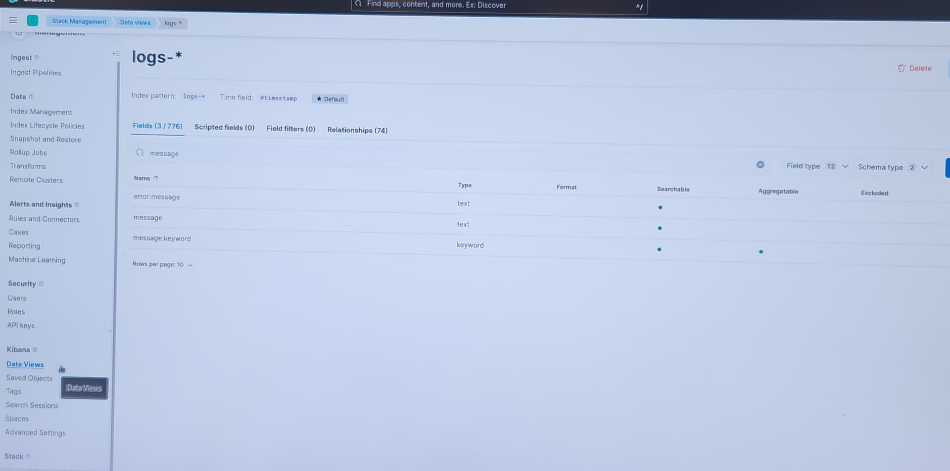

  • In Discover, I do have access to the text field (message) and I see the keyword field for the new mapping (message.keyword) in the KQL search bar, but I do not see the message.keyword in the 'available fields' on the left column of Discover. I do however see message.keyword in the Dataviews under Stack Management.

Ok. Thank you and that is correct. I can see it in the KQL bar as shown in your picture. Also, I am on version 8.4.3.
So when I start typing the script, "message.keyword" pops up showing it's availabe.
But when I finish the script, I get the same error "No field found for [message.keyword] in mapping". Did I miss a step?
Below are the pictures of what I'm talking about.

  2. does the data view reference both indices that have the new mapping and some that do not have the new mapping... That seems likely that can be the issue....
The actual test document on the Right side of the last image can you find message.keyword in that document. I suspect not because the Index Pattern is Grabbing a document from some other document that does not have the message.keyword field
