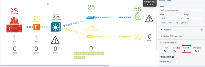

Here 2 screenshots available when I did refresh 2 times.
Some widgets works and some are not each time I refresh.

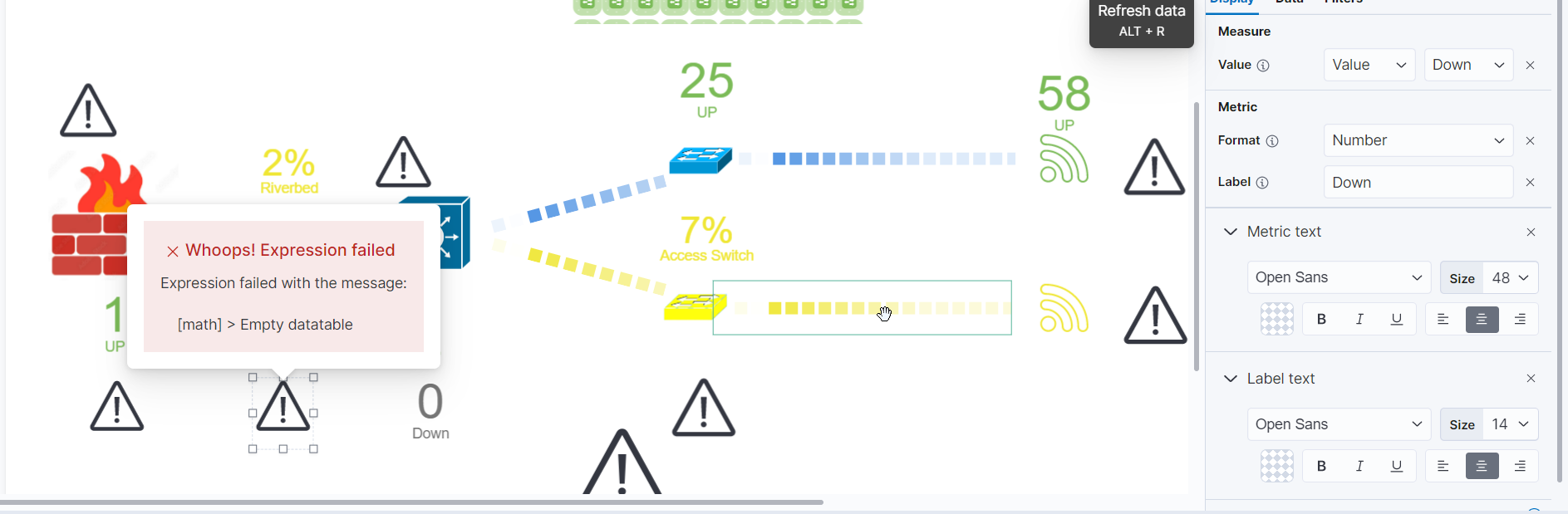

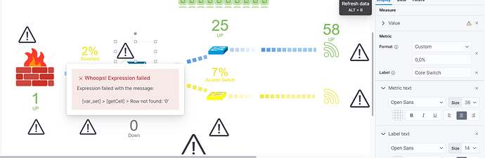

Here are some screenshots of widgets with errors.
Appreaciated

As time passes your datatable sometimes has data other times not (since you are looking at the last 5 minutes based on your query this is probably a smallish sample set).
See this solution for handling a potentially empty datatable:
You should be able to prevent the empty datatable from causing issues for your getCell call too (note: getCell defaults to using row 0 if now value is provided, see the docs)

Hm, sounds like two different issues...
From your screenshots it definitely looks like you need to do error handling, this would have also thrown in previous versions of Canvas.
