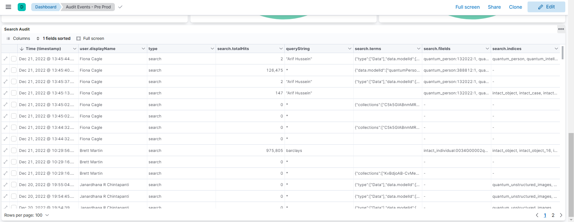

Horizontal scroll not visible in kibana dashboard
When i am seeing the data through kibana search.
This horizontal scrollbar issue is big trouble for us especially when there are more number of columns and rows.
While seeing the data, horizontal scroll bar is appearing only when we scrolled down the vertical scroll bar till end(i,e till the last row). Then to check few more columns we need to go back again to the top check it end and repeat the process again for other columns.
Is there any way and any settings to be done in kibana search so that the horizontal scroll bar will appear by default in the kibana search without going to the last.

I am looking in Discover in kibana..And I am using version 7.5.0.
In this I want horizontal scroll..Right now for scrolling horizontally I need to scroll down to complete last row.

I am using saved search and adding it to the dashboard.

You are on a really old version of Kibana. I tested it and indeed the scrollbar shows up only at the end of the listing.
In advanced settings you can reduce the number of rows to a smaller number, say 10
So now in the dashboard your saved search has only 10 rows and will show the horizontal bar without scrolling
