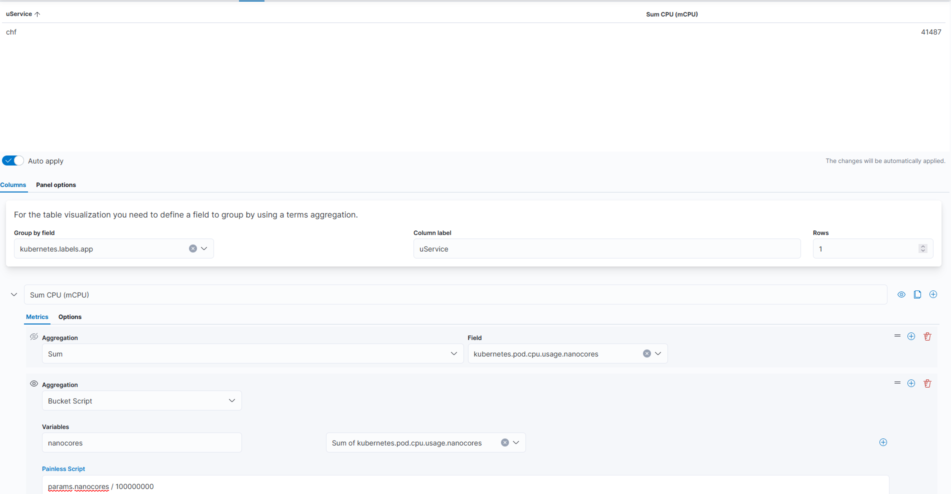

Sum them together, which would give: 36210, and display them in a table. I can't seem to figure out the table piece. I have tried just doing a straight sum of kubernetes.pod.cpu.usage.nanocores but that gives a different result, as kubernetes.pod.cpu.usage.nanocores is not an average, it's just a point-in-time value. I need to get a sum of a set of accumulated averages. The table I have looks like this:
I have also tried to just take the average, but then I need to multiply that by the number of pods. I can't seem to find a metric for that which works.

Thanks for your reply! It's the Table of of the same visual:
I tried Overall Sum (there is no option for Sum to aggregate the previous collection). It still just shows the average:
I think because there is only now a single value to sum up. The individual buckets have been accumulated into a single value.
I can't use Series Agg:
So the non-table version would look like this, Yeah done think TSVB table is going to work...
I think Lens Might, but I don't have a 7.17. to test with
And here is just a metric that could be over the whole time frame or the last bucket
Thanks for your help @stephenb That explains it. Lens will work but there is no option to do the manipulations I need using a Bucket Script.
@eeijlar that bucket script seems quite easy to be translated into a Lens formula.
That one is straightforward but I have another one that I am not sure if I can do in Lens. I will look into it further. Thanks @Marco_Liberati :man_bowing:
