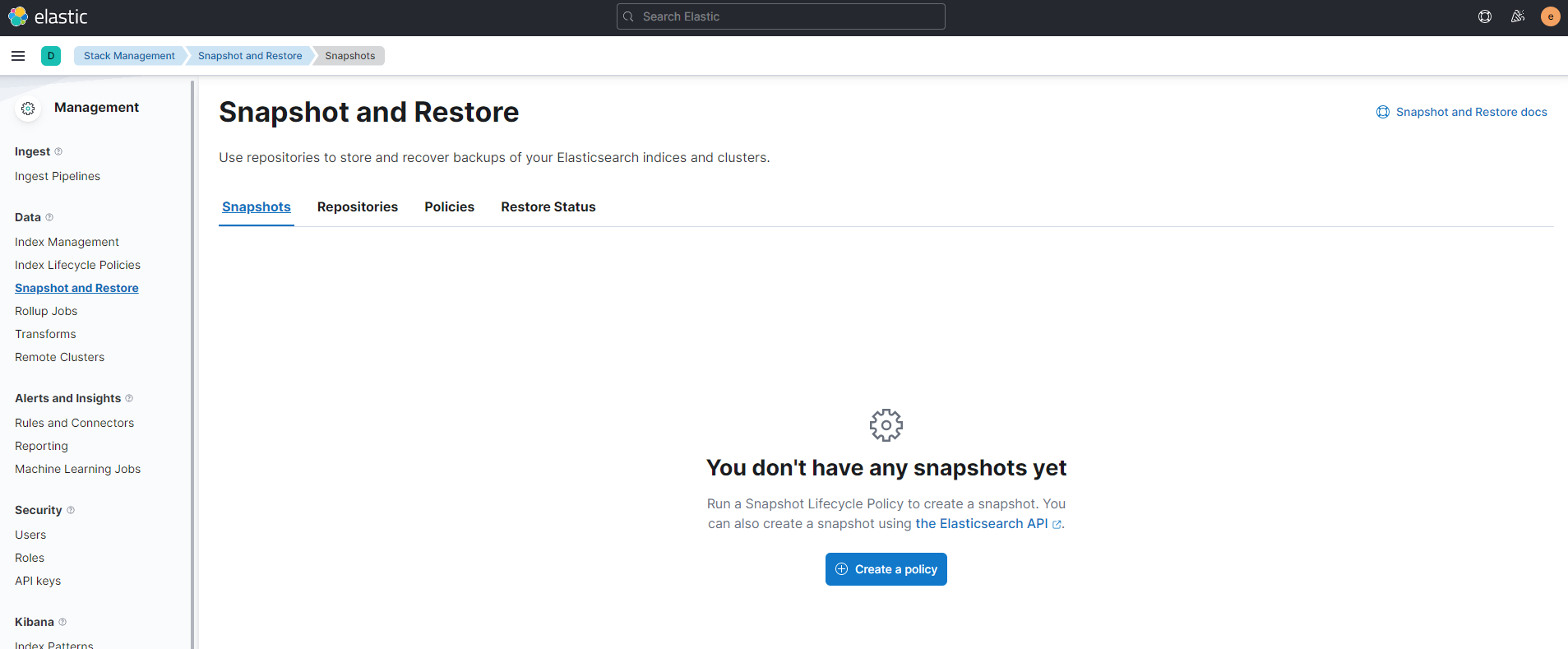

I made a snapshot on the 7.12 cluster, shared the snapshot using NFS, then created a new 7.16 cluster, mounted the nfs path, and registered the warehouse with the same name on kibana. After the registration, I browsed the snapshot UI and found Didn't find any existing snapshots, is this the wrong way to do it?

Did you mount the repo on the newer cluster as read-only?
Current result
cat /proc/mounts | grep nfs
192.168.10.141:/home/esdata/snapshot /home/esdata/snapshot nfs4 ro,relatime,vers=4.2,rsize=1048576,wsize=1048576,namlen=255,hard,proto=tcp,timeo=600,retrans=2,sec=sys,clientaddr=192.168.10.26,local_lock=none,addr=192.168.10.141 0 0
PUT _snapshot/local
  "type": "fs",
  "settings": {
    "location": "snapshot",
    "readonly": true
GET /_snapshot/local/_current
  "snapshots" : [ ],
  "total" : 0,
  "remaining" : 0
The above is operating on the New Node.
On the new cluster, I deleted the previously registered repo and created a new type:url repo. The same operation, the prompt I got is still [local:snapshot_2] snapshot does not exist
PUT _snapshot/local
  "type": "url",
  "settings": {
    "url": "file:/home/esdata/snapshot"
POST /_snapshot/local/snapshot_2/_restore
  "error" : {
    "root_cause" : [
        "type" : "snapshot_restore_exception",
        "reason" : "[local:snapshot_2] snapshot does not exist"
  "status" : 500
I noticed that other people's solutions are to directly overwrite the data of nodeA to the data of nodeB, but I saw in the elastic documentation that nodeB can only mount the NFS directory in read-only mode. Is my understanding wrong?
I installed the cluster of version 7.16.3. I replaced the snapshot directory generated by version 7.12.0 with the directory created in advance by version 7.16.3, and then prompted that "[local:beifen/WMgGeuykR-KMhD96mwcnRw]" was missing. In this case, it should be It is not possible to directly use the method of directory replacement.
I want a more professional answer.
