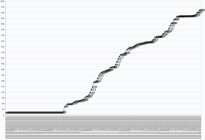

Hello,
I am using vega-lite to finish my graph, but meet something confusion that how to set maximum degree scale in x-axis, just look at my pic

My x-axis data is too large, I tried to cut my data from ES DSL, but it will impact my data integrity,because cumulative_sum and this aggs not size paramter, it I wanna adjust my size of x-axis in near 30 days, how can I fix my code?

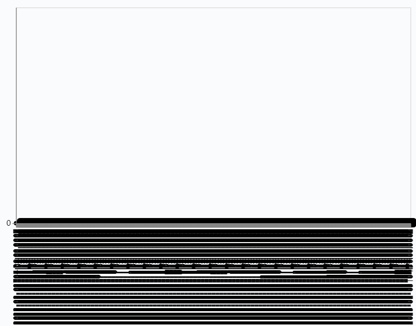

It generate this pic
Now I wanna using extended_bounds control its date range and "interval": {%autointerval%: 10} control its spot count in x-axis, but it doesn't work..
But I have other question, if %timefield% works, whether it effect the result of aggregation in cumulative_sum, cumulative_sum in my project need aggregate 3 month data even more but display only near 30 days , so if date_histogram aggregation just filter near 30 days data, I fear that the finnal result is fault.
this pic is filter datetime before, you can see the highest y-axis and the lastest time is about 1000.
this pic is filter datetime after, the highest y-axis is become 200 about,
so its finnal result is effected, I wanna solve this problem that if I display only 30 days in x-axis,
how can I make the finnal result right?
