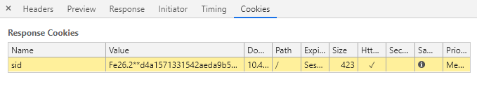

I'm using kibana 7.6.2 version and I tried to execute a cross-site domain access to Kibana bypassing login page.
After I launched http post call to Kibana login endpoint, attaching username and password,
I obtain a warning in Cookie section.
If I moved the mouse pointer to (i) of SameSite column, I get the following message back:
This Set-Cookie didn't specify a "SameSite" attributed and was defaulted to "SameSite=Lax" and was blocked because it came from a cross-site response which was not the response to a top-level navigation. The Set-Cookie had to have been set with "SameSite=None" to enable cross-site usage.
cookie
it seems that in version 7.6.2 the SameSite setting to None is not enabled, but in the http_tools.js there is a boolean variable isSameSite which by default is set to false.
How can I fix this bug?

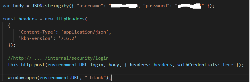

It is an Angular script that executes an http post call to 'internal/security/login' attaching username and password as body, and Content-Type: application/json and kbn-xsrf: 7.6.2 as http Header.

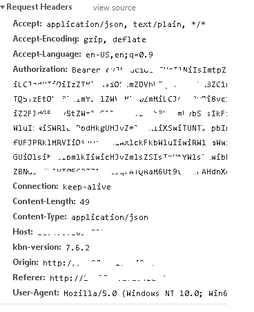

If I understand correctly, you're having success with the Talend extension but not your angular script, correct?
Can you share the request and response in each case?
TALEND REQUEST - RESPONSE
talend_request_header
talend_response
SCRIPT REQUEST - RESPONSE
script_response
script_request_header

From the requests you shared everything in the request and response is correct.
