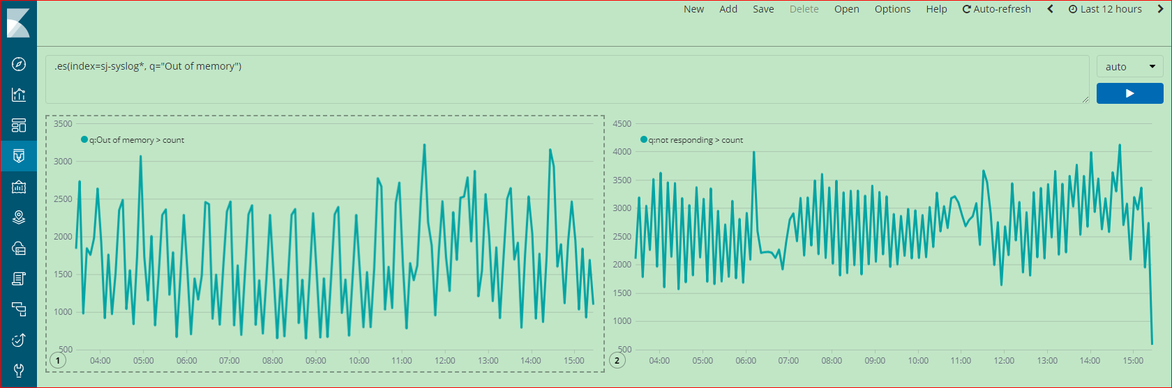

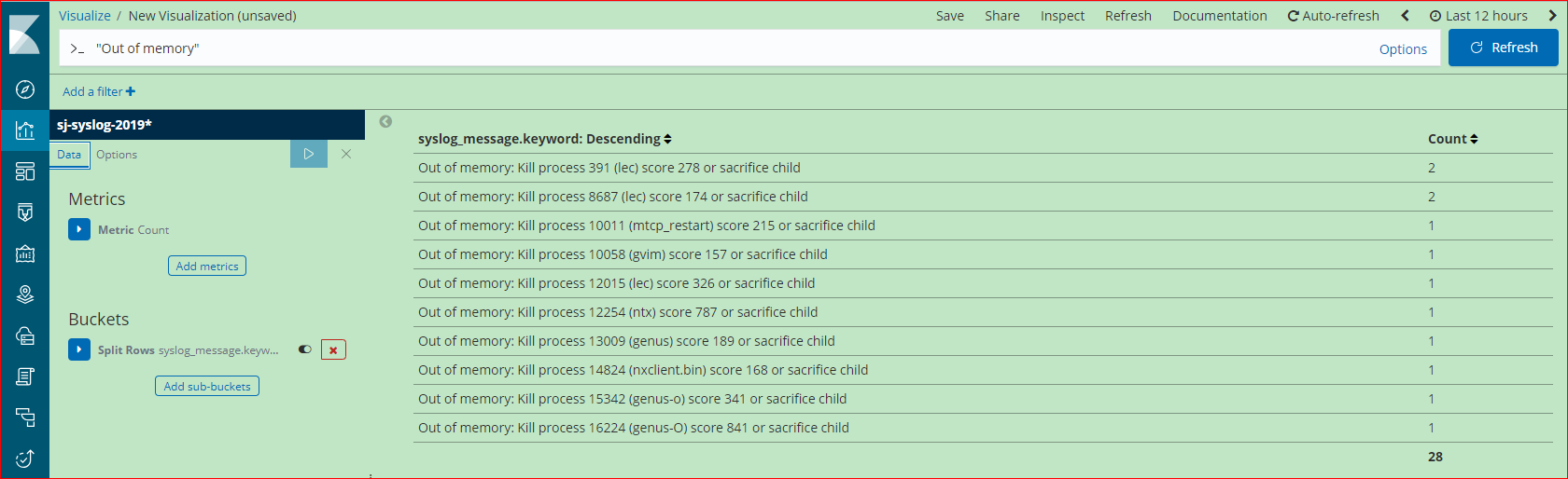

When i do .es(index=sj-syslog*, q="Out of memory") this should show me the searches for the Out of memory from the Index dpc-syslog but it showing wrong as i have only 28 Out of memory count for 12 hours while Timelion show multiple variations.
and
