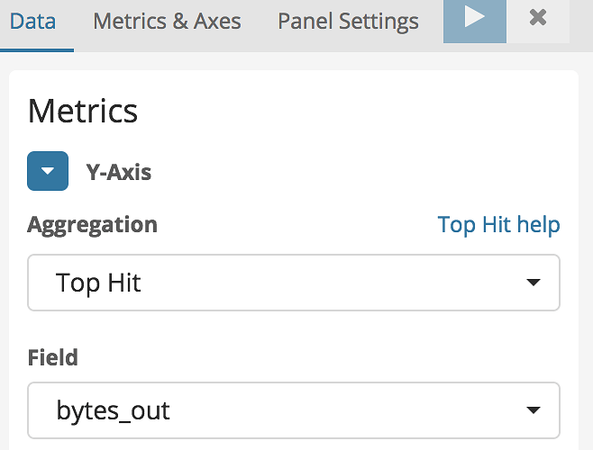

Hi @Palkos,
You should be able to make a Saved Search matching the phrase Assembly Version. Then, make a visualization using that saved search with a configuration something like:
