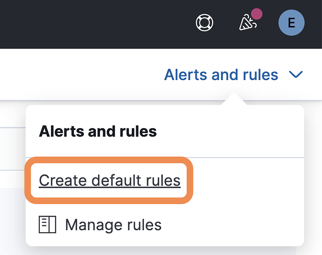

You can trigger the same flow through the menu!
Hi miltonhultgren,
thanks for replying. I am just rebuilding via ansible my test environment :slight_smile: .
I will take a look for that Menu in 7.17.4. I wonder I did not see it.
Keep you updated.
Cheers!
PS YEP - that's it! Thanks!!!
