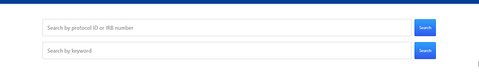

I have created a new search box specific to one field search, exact search. how can i make it case insensitive?
I have created 2 search box with react-search-ui out of box library.
one search for specific field search with exact match and other generic search that search all, like below :
Since the exact search is implemented using below:
onClick={() => {
setFilter(field, value);
Is there a way to make the search insensitive ? or can i change the setFilter to something else to work ?

it doesnt filter on that specific field though right ?
No we dont want to normalize the data. is it possible from the code base itself to do the case insentivity check ?
where to set the field name on the setSearchTerm?
