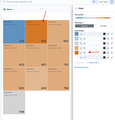

I don't think you can do that with Kibana visualizations without getting into coding something with Vega.
The closest visualization I can think is to use the new Metric visualization and color-encode your metrics to highilght the biggest value with something like this:
On the new metric, go to Appearance and select to run a dynamic color encoding
Then tune the distribution of values to add a 99 percent class that will give color to the highest value in your data distribution.
Hope it helps!
